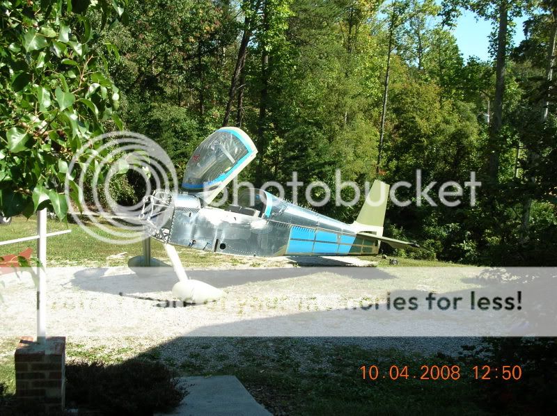

Nothing earth shattering here but since I was on vac and getting transitioned over the past couple weeks, nothing has happened with the build.
This weekend, I pulled it out so it could see the sky for the first time! Cleaned and reorganized a bit to get ready to hang that engine tonight!

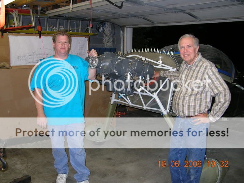

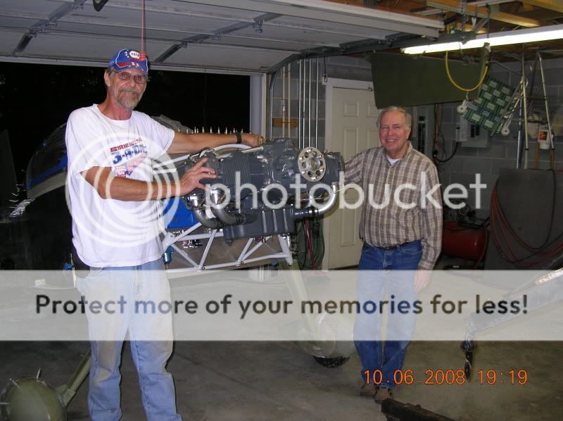

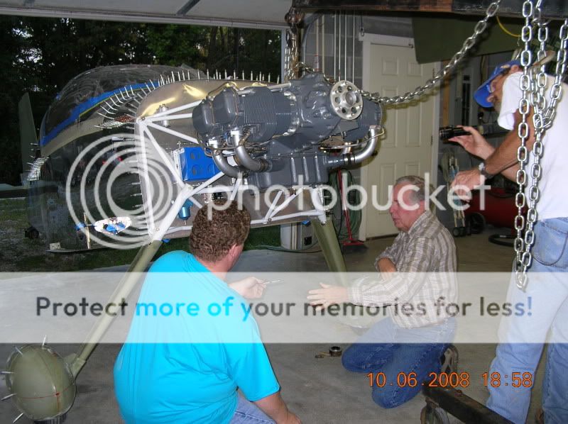

Milestone! Engine Hung!
Followed the guide to engine hanging off of the VAF site and in less than an hour start to finish, I had an engine hanging on my plane!
Thanks to my uncle, Al Swan and a local RV7A builder named Paul Bennett for their help! (Paul did not know what he was in for when he emailed me yesturday morning asking if he could drop in!)
Could not have done it without them! Also thanks to Tim McGinnis and Bob Dougherty for the phone support prior to the event!

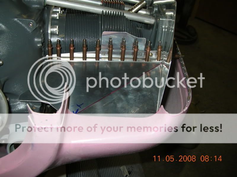

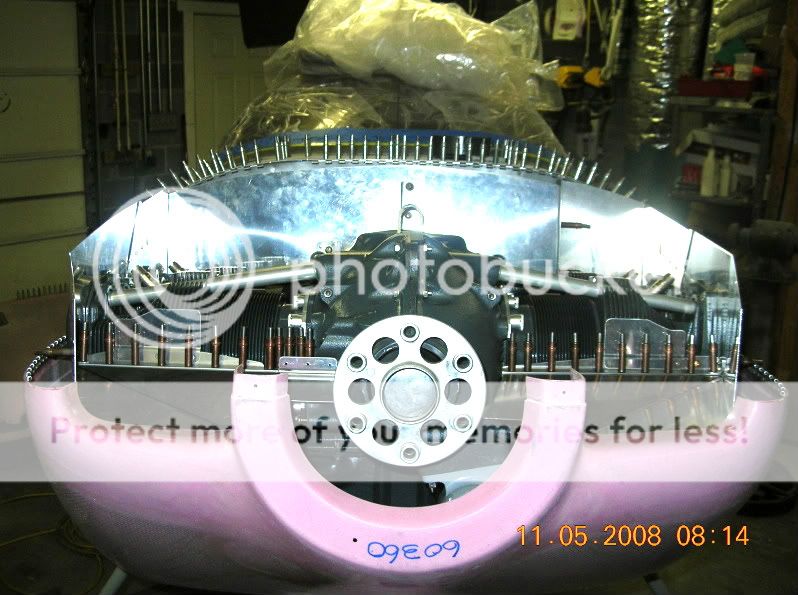

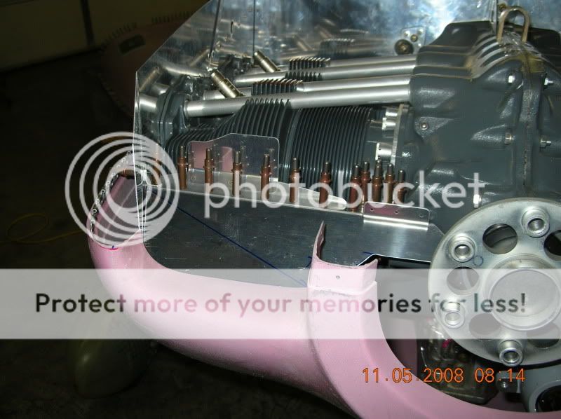

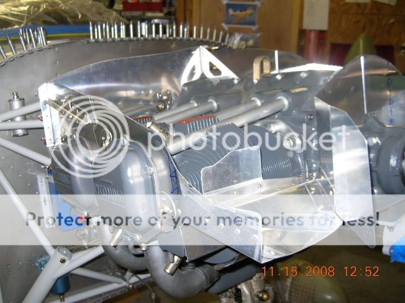

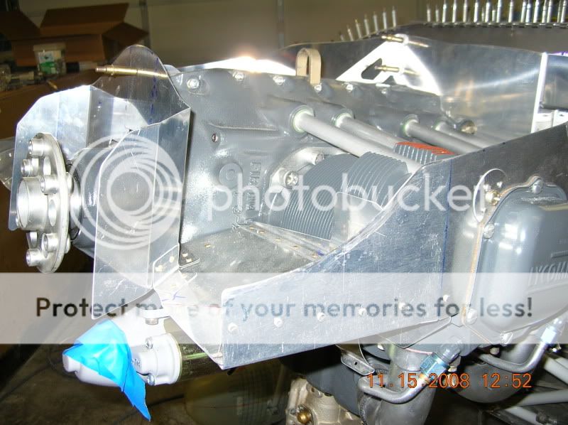

Been working on baffles. I have the new latest and greatest redesigned baffle kit from Vans... It has been some work trimming it to fit my narrow deck engine. There are more fillets, bosses and areas of reinforcement on the narrow deck which interfere with the cutouts for the engine.
Anyway, I have most of it on there at this point and the lower cowl fitting up to the intake areas. Lots more work to do before these are finished. I am just taking my time and making small trims here and there to get it to fit.

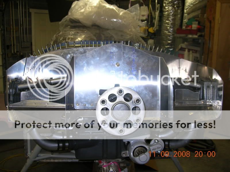

Here are the time eating details that I have been working on the past few weeks.

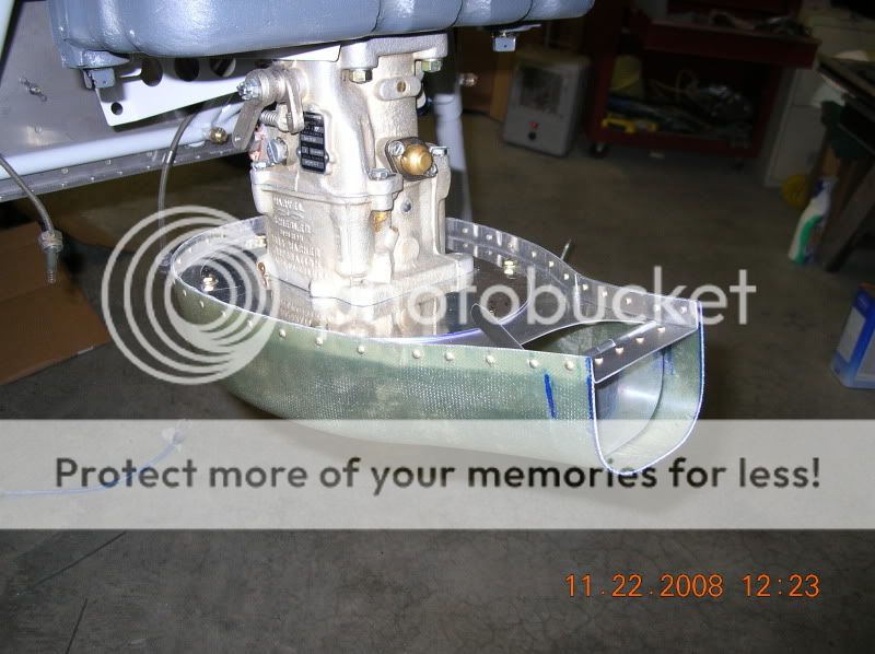

I finished up the baffles less the seal at the top:
Built this little pain in the rear, those that have not made this yet and are using a vertical induction, just go ahead and order you some stock to make the carb mount plate out of because you will need to shift the airbox over to the co-pilot side to prevent the box from hitting the cowl scoop when it shakes.....:

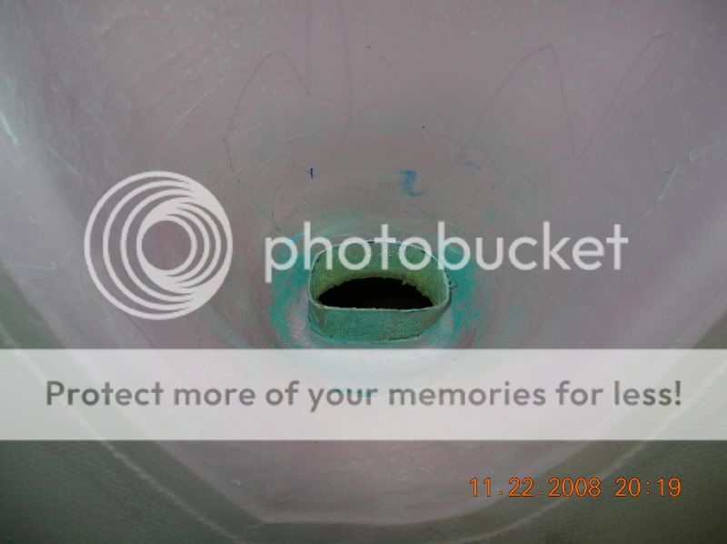

Finished epoxying and riveting the hinges to the top cowl and made this little extension to the inlet. This does not look like much but it is a ton of work!

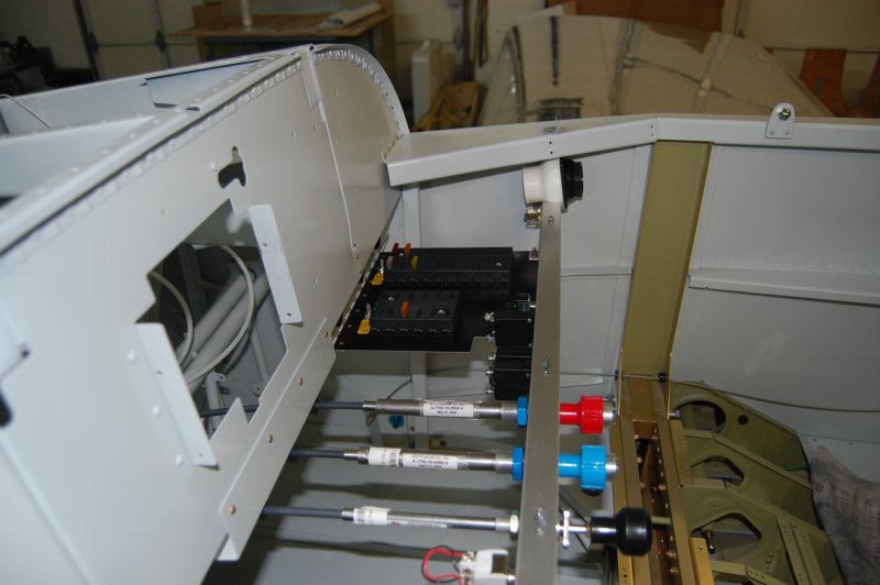

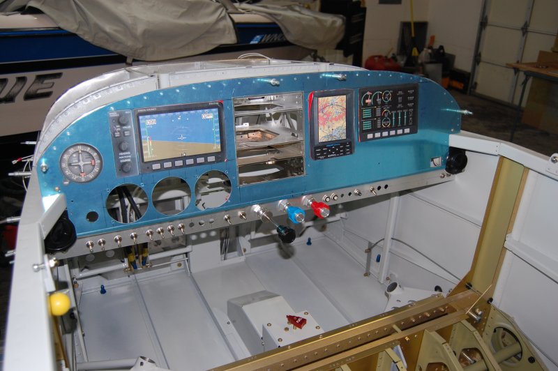

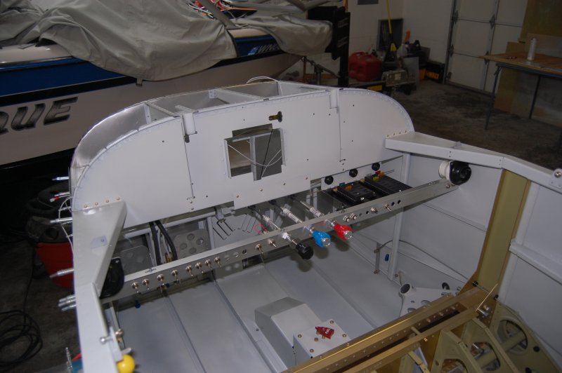

I haven't posted an update in awhile because I've been working on tons of little things that really aren't that exciting.

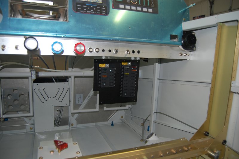

This week it's been the switch panel. I had a fab shop bend me a piece of .050 that's the same size and angle of the Van's control quadrant bracket with the only difference being the width.
I've kicked around a lot of fuse block locations but decided like others that a flip down panel would be nice. I ended up riveting a hinge to the bottom of the old control quadrant bracket and used that for the back. I used small pieces of angle and nutplates on the switch panel for the front.
The nice part is the panel slides right off the front with the switch panel left behind.
Here is the old throttle quadrant bracket with grommeted openings for the wiring to the fuseblocks.
I believe it's time for some wiring!:D

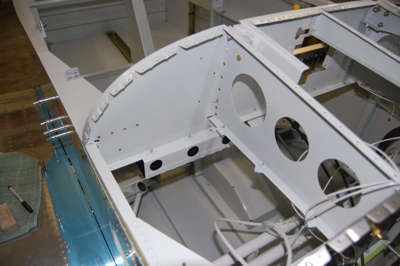

SB wings finally done after 312 hours!
Tonight I've riveted the last flap hinge on the wing and mounted the flaps next to the ailerons on the wings with newly bended flap hinge pins (I removed some center hinge eyes). That means except for the wingtips my wings are done!
More details on my wiki at: http://rv7a.tauker.net/
Next: the fuselage :) (I already clecod the firewall together)
