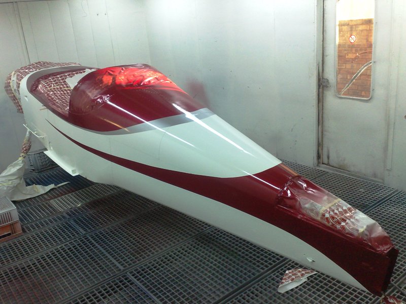

3 Year Anniversary!
Hi Rvators
Today, 15 May, to the day is the 3 year anniversary of my RV kit arriving in my garage.
2275 Hours of building later and fitting that today, the painter finished painting it! :) :D :) :p
I am collecting it on Friday to take back to the Garage, for that infamous last 10%.
The Fuselage in the paint booth, just finished.

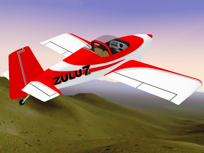

The Design.
Kind Regards
Rudi

Nice design Rudy
Rudy, I really like your paint design...I think it may be on the short list of designs for my -7A.
Thanks Chris! The practice kit was definitely worth the $ and time! I'm glad you came and got me started off on the right foot. I'm trying to hold back on building this thing cause I don't have enough saved up for the wing kit yet! :eek: Don't want to sit around with nothing to do! I just sent an order to Vans for some proseal... I've got a feeling I'm fixing to make a mess...

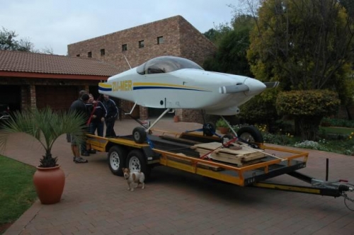

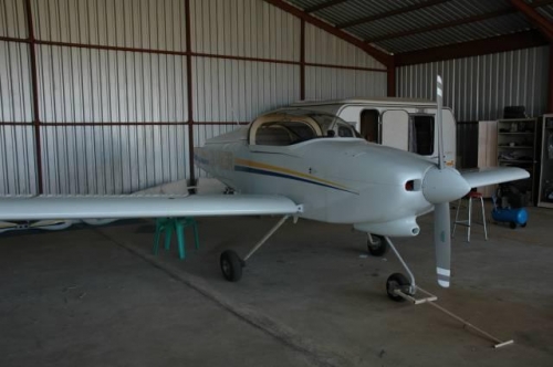

Today we have kicked ZU-MER out of the nest and moved to the airfield - Brits, South Africa.
From when we had it one the ground to where both wings were on with all bolts in place and all holes drilled etc. it took about five hours and we had a short lunch break. Only three guys. I must say that the nuts are not yet in place and torqued. Everything worked out 100%. In the end the sleepless night I had about sweep and incidence was not necessary.:)

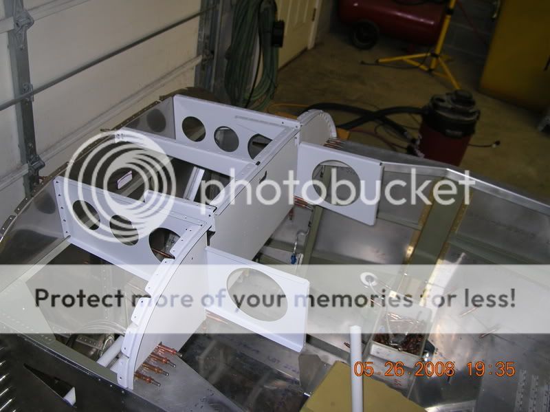

Status "Brantel"
Finish kit is suppose to ship this week with Partain.... Hope he gets it here quick! I need parts!

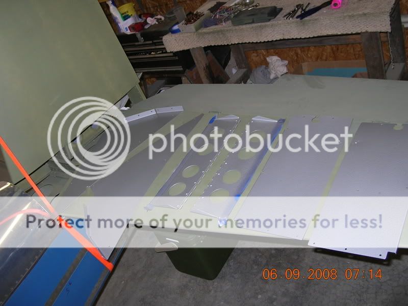

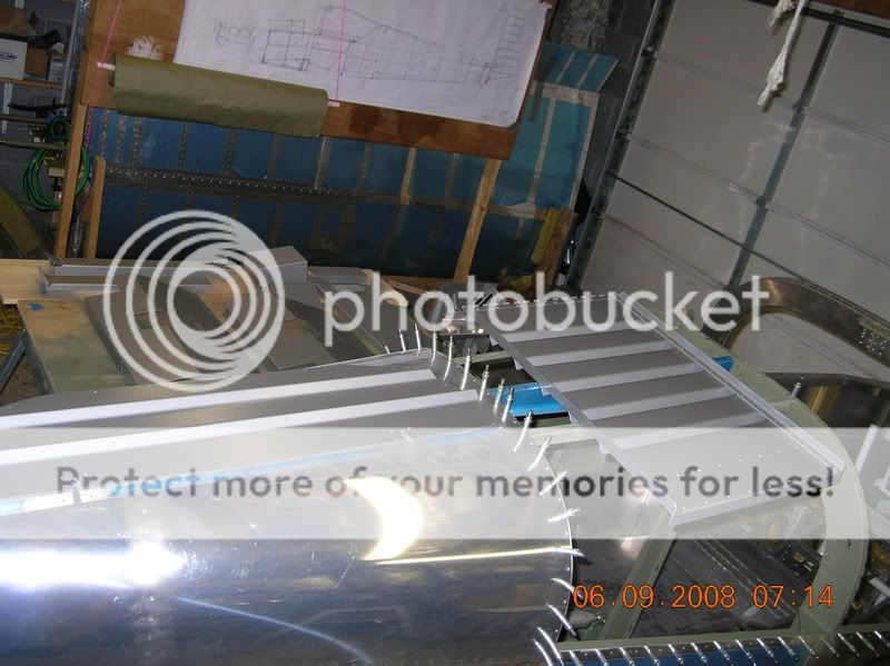

Spent a few hours over the weekend drilling, deburing, dimpling and priming the front deck structure. This took what seemed like forever. I primed it all light grey using my Stewart Systems (AFS) stuff in order to make it easier to see under their when I am upside down under the panel in the future.
I took the hint off Chad Jensen's website not to rivet the stub ribs to the center subpanel yet like the directions tell you to. Not sure when to go ahead and rivet this structure to the fuse. I thought it might be nice to wait till I paint the interior but I don't want to paint it too soon and then get in there and mess it all up while working on the canopy.
I am not using the release mechanism so I am not putting in the "hat" section which would be right in the way of one of the radio's as they cut thru the subpanel. I will use a pullable pin or bolt instead. Five minutes of pain and suffering to get out a pin when and if I ever need to get the canopy off fits my plan better than the release mechanism.
Should I rivet this all in before working on the canopy?

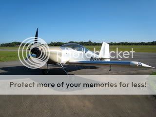

First Taxi at the Lafayette Airport
Here is a shot of my "baby" after first taxi. I need to have my DAR stop by but I have to weigh it and calibrate my fuel tanks before I can call him. My car temp gauge said it was 105 degrees on all that asphalt.
The engine seems smooth and my MT prop makes a whistling sound. I have a ton of little things to do but I am getting close.
Am I happy I painted it before first flight? I had no choice as my feline friends did a number on my wings in their caddy. It put me back at least six months but now I am happy. With all the heat and humidity, I believe I am better off in the long run.

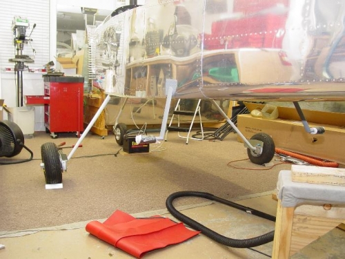

Up on the Gear and out of the Shop...
It felt so good to get to this point I just had to post a status update. I still need to do a little tweaking on the canopy frame before I get it powdercoated (I ordered it bare) and make the Big Cut.
(a little plug for SteinAir - they're a great bunch of guys and just down the road from me...)

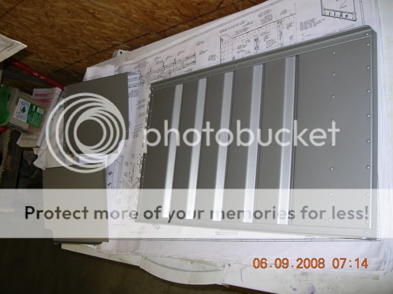

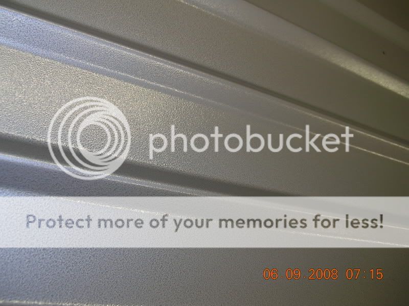

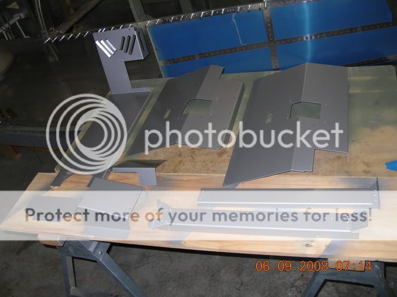

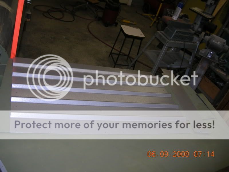

Well since I am having to wait an extra month for the "delivery" of my finish kit and I am out of parts otherwise, I decided to bite the bullet and use the time to paint the interior.
This Saturday I pulled everything I could get out of the cockpit and painted it. I used the Rustoleum Hammered paint in bulk. I thinned it 8oz per quart of Xylol per the directions which proved to be perfect.
This stuff has a learning curve on how you spray it. Too little and you don't get the even hammered apearance, too much and you get what looks like runny metalic paint. There seems to also be a trick to getting the most even coverage. I found that by spraying a medium coat all over and then waiting for about a minute and spraying another medium coat, I had what it took to make a nice even hammered finish. This stuff changes before your eyes so it is difficult to tell what you have until it is done doing it's thing.
Overall it was not hard to figure it out. The results are fantastic! I love this stuff! It seems to be the perfect thing for interiors as it has some hidding ability and seems to be easy to learn how to spray it.
This stuff was able to be handled in about an hour after spraying (95+degrees Saturday). I just let it sit yesturday and cure. It seemed to change a little more from Saturday night till this morning. It took on more of an even hammered finish. I suspect that was the remainder of the solvent evaporating causing this.
I checked for durability a little and this stuff seems to be pretty tough already. Others have reported great toughness so only time will tell.
Here is the finish it produces:
Here are the shots of all the parts I pulled and painted:
Now I am going to take the interior in three steps. I want to do the baggage area first, then the mid section, then the forward section. This is so I can mask, scuff, clean and paint before the surface oxidizes and looses its grip. I will do this in the evenings this week. I don't think I would have enough time in a session to do more than that in one evening session.
Hope the inside goes as good as the removable parts! If it does, I will be a happy man! Wish me luck!

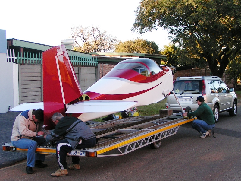

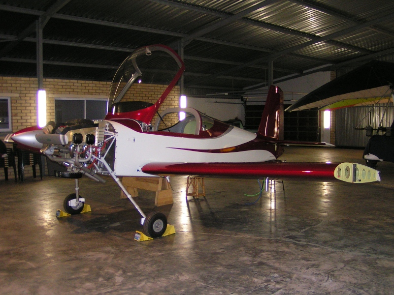

Well the bird has left the buildings nest, the garage, and gone to the bigger nest , the hangar, to get the final assembly started. A good day all and all, arriving safely at the hangar, and finishing fitting the wings the same day.
Life is good.
Getting everyone to help with the move, Dad, Brother and Wife
Safely in the hangar with wings on for good
Regards
Rudi
Thanks, yip it is a 'hot' red, isn't it? :D
Auto Paint: Car make= MG Rover, Colour=Hot Red , model year=?2003? I think. It is on the auto paint colour charts.
For Reference the silver trim is from the same year and model same car, but can't remember the name of it.
Regards
Rudi

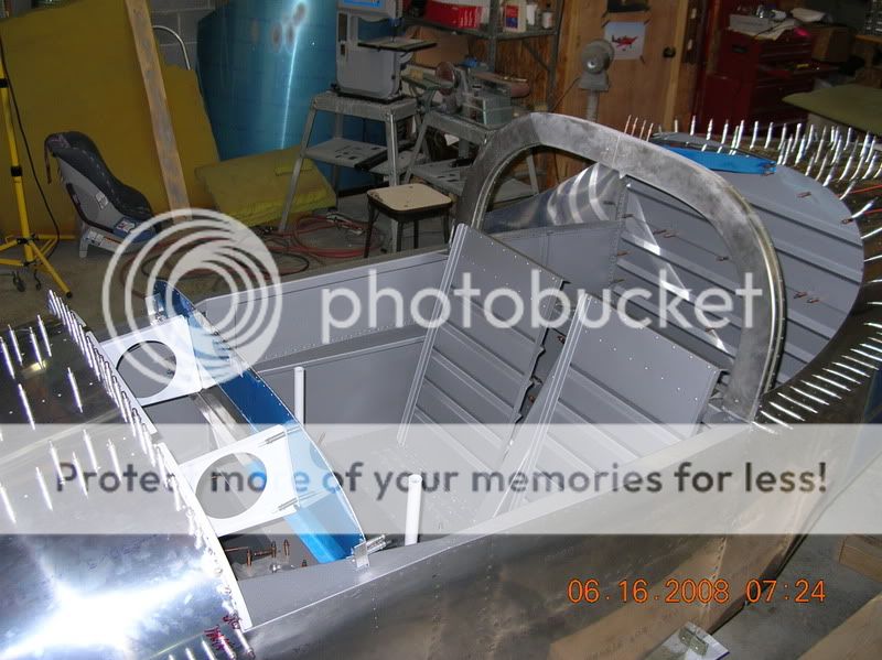

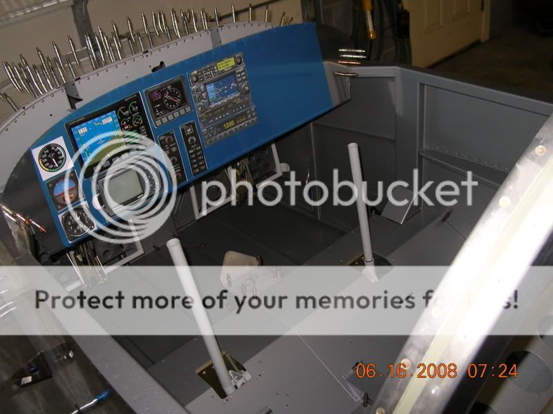

Status Brantel
Calling the interior paint done...
I finished everything up this weekend that I felt that I could do before starting the finish kit.
Did not paint the rollbar or the inside of the aft top skin due to the canopy work that is to come.
Also did not paint the fuel selector plate because I am not sure what I am doing with that yet.
Reinstalled everything possible back into the interior. Installed UHMW tape on the seat back bar front and top surfaces. Hard to tell the tape is even there. Hope it helps that area from getting trashed so quickly in the future.
I have not drilled the anlge to the back of the panel yet because I will be needing an extended panel.
Partain's driver called and said that he is on his way with my finish kit!

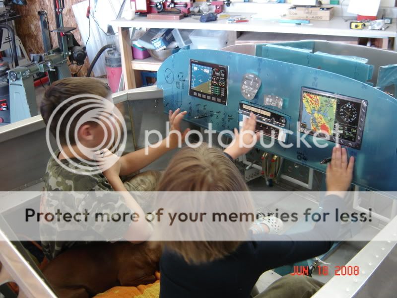

seal of approval, not DAR
Haven't made much progress lately with Spring runoff work and hosting grandkids but at least they approve of the panel layout.
Austin the pilot, Kylah the Navigator and Dog is their co-pilot wondering why they keep doing loops.
I may be slow but having fun.

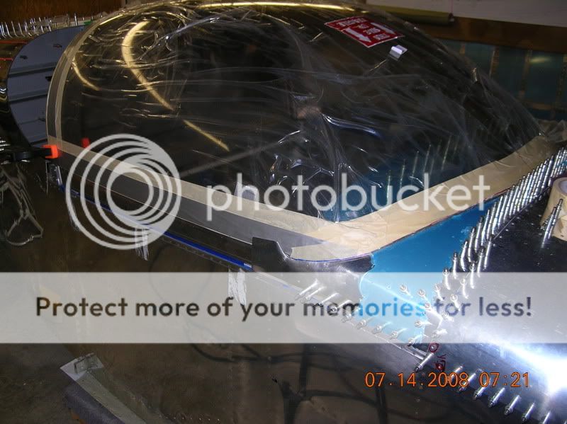

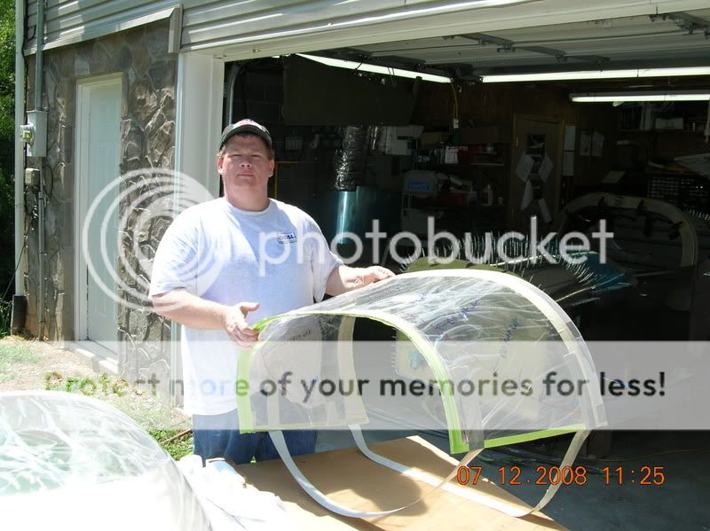

Made the big cut!
Started cutting the bubble this weekend.
After the initial fitting, made the big cut!
Total non event.... It was about 95 in the sun on Saturday and the bubble was like a wet noodle.
Working on some more detail trimming. I also trimmed the sides off and started working on the area up at the front corners. Got the right side almost there and had to stop. This week is bible school week at church and I am part of that so no RV building this week at all!
