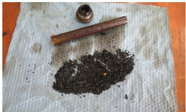

Recent horrific fatal accident directly contributed to the failure to clean the oil suction screen and the resulting loss of oil pressure. (Screen shot from accident aircraft)
Full story here:

How do you draw the conclusion that the screen caused the engine failure?
Lycoming SB 480F specifies that the cleaning of the sump screen, oil filter examination as part of "changing the oil". Despite this instruction, the first time that I changed the oil or my certified airplane that had been maintained by a professional shop - the sump screen was so full that I could not push it out. Never seeing this before I ran to my engine shop fearing that I bought a boat anchor. The shop manager just laughed saying that it was carbon and not abnormal! I couldn't believe that, as we discussed normal shop practices he simply stated that although a good shop will do IAW "oil change" SB , most don't! I imagine apart from the experimental world where we tend to be more diligent about doing thing right; that the average shop maintained airplane looks more like your pictures. :mad:
I join you in highly recommending that it gets cleaned IAW, but I don't see it as the cause of said engine failure. Perhaps I read too fast?

Just curious but if the screen is blocked is there some form of oil bypass?
Figs
NO. It sits in the only path from sump to oil pump inlet. There is a small bit of leakage around the screen, but that also will clog up with carbon chunks if that is the clogging source.
The NTSB drew the conclusion. Lycoming had an input.
A high percentage of the material in the posted photo is actually metal, per the lab report. That's probably from the failed components, given the report also states the pilots told ATC the engine had failed but the prop was turning.

I saw it as carbon, thanks for showing me otherwise.
Not withstanding, I can't believe all shops don't clean it with each oil change or at least annual! I had 2 engine, maintained (or not) for the life of the engine by certified shops & personal, yet on my 1st oil change there was so much carbon that literally, I had to run a drill through the screens to start to get the carbon out. :mad: yet, homebuilders get a bad rap in many certified shops !

This was a turbocharged engine and I would speculate that those engines make more carbon than normally aspirated. Have never found many particles or chunks in the suction screen on engines that the screen gets checked regularly. Have seen a couple that had a lot.

A friend with a 260 Comanche was doing his annual, so I offered to pull and clean his suction screen. There was carbon/lead buildup, nothing magnetic, and seemed to crush into powder. Afterwards, his oil pressure was significantly higher, he was able to back off his oil pressure relief valve that his mechanic had been bumping up over the years!
Based on the NTSB data on this accident, this is what happened here as well. It seems that there are a lot of mechanics that don't know that the Lycoming has this cleanable suction screen, probably because Continental does not have one.
