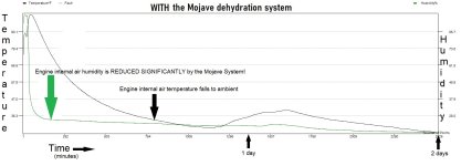

Great information guys! I too wanted to quantify the effect of engine dehydration and try to show with data that it is effective in maintaining a drier atmosphere in the engine crankcase. My graphs show data collection in the oil filler tube on a Lycoming O-360. My system is simple with a single sealed pump pushing dual filtered air into the breather and extracting it from the oil fill tube. It’s a closed loop system which extends the life of the media between rejuvenation. Also I wasn’t happy with the cost of available systems so inline with Einstein’s philosophy of everything should be a simple as possible but no simpler, over time I developed the Mojave System.
www.rbaviation.com/mojave
Here are a couple of my data graphs.

Thanks for the data Don this is very helpful. I was assuming saturation and condensation pretty soon after shutdown as the engine cooled. That is why I started the high flow purge. I use a check valve to prevent back flow into the desiccant bed so only one hose goes to the engine. Calculations for 4 lpm and based on 4 gallon crankcase volume indicate 98% displacement in ~30 min.
What I have been wondering, is if there is any liquid in there that would evaporate and drive the humidity back to saturation. Crude testing indicated it was not likely but it was not a continuous data plot like you have, that is perfect.
Will you be running the test for a longer period, say a week, to confirm the crankcase stays dry?
Mac - - excellent question, but it may be more about premature issues and a higher cost for components at overhaul. Or we could just fly more frequently (like Vlad) and it would last much longer. We do know that low humidity will drastically reduce, or stop corrosion, and that (slipper) camshafts are one of the weak links. Not sure about the roller type. Personally, I just don't like guessing about the efficacy of a tool. It's fun and educational :) If we all keep this up someone just might end up with TBO information.
Thanks for the comments, I plan to continue collecting data and will add to this thread in the future.
Jeff requested data on the humidity level without introducing dry air but I see John has captured that in his first graph so I will focus on measuring the longer term retention levels after running the sequence described in my first post.
I went open loop because the breather tube is not accessible from the outside of the cowl and as others have stated, it is quick to attach and get functioning.
Appears the purge function is worth while as it significantly reduces the moisture level prior to introducing the dry air.
