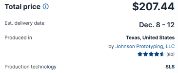

If you don't mind, how much did it cost to print these? I've been mocking up some duct adapters but I was planning on printing a plug in PLA and making the flight article from fiberglass.
I was also thinking of modding my printer to run nylon but that might not be feasible...
These 3 parts cost $400 at 3d Hubs.
$400 sounds like a lot of $$$ for some plastic parts. But the labor involved with making something like this from fiberglass (and nevermind trying to integrate vanes into that), makes 0.4 AMU's totally worth it.

I used the HP-MJF process with nylon 12 (PA-12) for these ducts.
For hot "underhood" applications such as this, I'd only use the HP-MJF or SLS processes with nylon 12. With all the various vendors out there nowadays, it's so easy to email your stl file, wait a week, and have robust, high-quality parts.
It would be interesting to find out if this could be printed in PA-CF (nylon carbon fiber) filament. I have a couple of rolls I'd like to try out.
