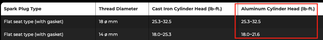

I have an eMag which uses smaller spark plugs than normally used by my O-360 cylinders. As a result, an adapter is threaded into the cylinder, and the Small plug screws into the adapter. What is the torquing technique? I would think the adapter would be torqued to the same value as Lycoming specifies for standard plugs. Then, since the smaller plug has a smaller radius of threads, a lesser value of torque would be used to seat the plug into the adapter. Does any one know how this is actually done, or can direct me to documentation ?

After reading it, it seems the 18 ft-lbs is applied Only to the small plug, which in turn, torques the adapter into the cyl head. However the Lycoming specified torques for standard plugs seem to be in the 25-30 ft lbs range. So one might think the adapter needs to be torqued to that value.
But the eMag instructions caution specifically against that.
They say to torque ONLY the small plug to 18 ft-lbs AFTER the adapter is seated finger tight. I suspect what happens is that the small plug slightly expands the adapter, such that it is effectively seated, as if it was alone with 25-30 ft-lbs. torque.

OK, can someone supply?
Aviation plugs:
Auto plugs w/ adapters:
Brake assembly:
Wheel assembly:
