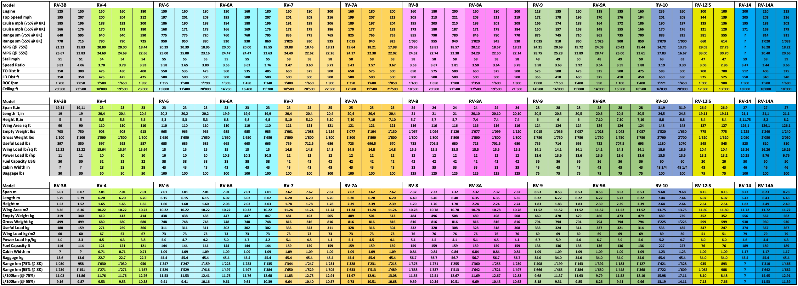

For interest, here is a version of the table with a row included for MPG. The calculated value is Range sm divided by Fuel Capacity USG. It looks like the RV-12/iS is the winner for efficiency, followed by the RV-9 and then RV-3 and at the back of the pack is the RV-10... which can haul the most.

hey good one Paul!
And interesting indeed. I guess the fuel efficiency of the -12 might be explained (sorry -12 fans :eek:) by the simple and old rule of drag being proportional to velocity squared... Flying slow with a frugal engine sure helps the MPG :)
Of note the difference in range between the -6 and -6A, no less than 70 miles :confused:

I guess this line of thinking should be expected since it is somewhat valid with the cars & trucks that we are all familiar with.
It is not (not universally anyway) valid with aircraft.
Like you have said, it is related to the laws of physics. It takes a specific amount of HP to pull (or push) a given flat plate area of drag aircraft through the air at a give speed.
Because for the most part, aircraft engines all have about the same level of efficiency in converting fuel into HP, physically similar aircraft typically have very similar fuel flows when flow at the same speed, regardless of engine size.
Example - Build two RV-7's that externally are identical in fit and finish, but one has a 150 HP O-320 and the other has a 200 HP IO-360. If flown side by side with the 200 HP airplane throttled back to match the speed of the 150 HP one, the fuel flows will be virtually identical.
The idea constantly perpetuated, that one should choose a smaller sized engine if their primary goal is operating cost / fuel economy is not valid thinking. A larger engine airplane can be just as fuel efficient as a smaller one, if the pilot will operate it that way.
There are other factors that make smaller engines good choices as well (lighter weight being one), so there is nothing wrong with choosing smaller, but better fuel economy should not be the reason.
I own an RV-6A with a 180 HP Lyc and fixed pitch prop.
I regularly cruise around at ~135 Kts at 6 GPH. Comparing this to the RV-12... in the same conditions, at 5.5 GPH it can do about 120 Kts. If I reduced power further to match the RV-12's 5 - 5.5 GPH, I would still be doing slightly better than 120 Kts.
I know that it is not an apples to apples comparison with the RV-12 having 5 ft more span (but lighter wing loading), but it still shows that the laws of physics are constant.
Bottom line is that the way an airplane is operated has a lot more to do with what it's MPG rating is, than what size engine it has.
thanks Scott, exactly what I meant and most of us already knew :)
Since being retired and enjoying flying as such, I usually cruise at low power settings, e.g. 19/2000. My -6 has a CSP, and 2000 provides an eerie quietness when reducing from take-off settings.
19/20 results in a TAS of around 130 at 4-6000ft, more at the higher Levels. Typical FF 21l/h = which is also 5.5usg.
Paul, how is the speed ratio calculated? Thanks
Speed ratio = Top Speed mph / Stall mph
The relatively high ratio for RVs (versus many other plane designs) is part of Vans "Total Performance" advantage which enables them to fly well both slow and fast.
