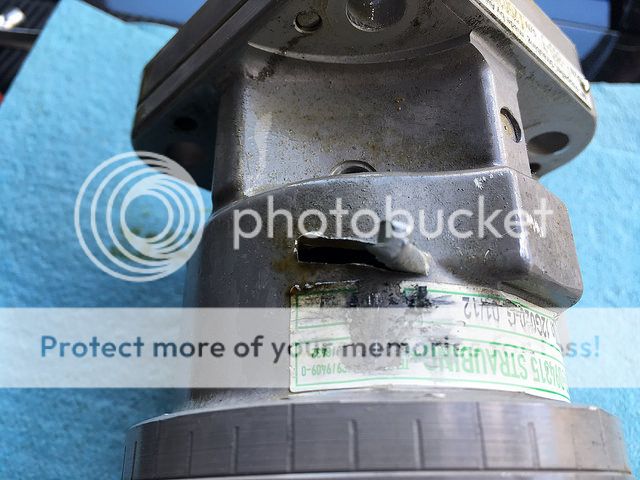

MT P860-3 Prop Gov fail.
>>If somehow you didn't overspeed your engine/prop you got very lucky. The other recent (identical?) failure wasn't so fortunate:
http://www.vansairforce.com/communit...ight=overspeed
Might be worth a look at engine monitor data, if you have a record.<<
Thanks for that link. I hadn't seen that and the pix look almost exactly like mine. The only difference is that there must be two pressure chambers in the unit to maintain pitch because my failure caused the RPM to drop rather than overspeed. I was about 18-19 on the RPM at full throttle and 800 on idle descent. Aside from everything else, the landing was much different due to lack of drag. First time I ever slipped the airplane to be honest to get the sucker down as a go-around would have been a nightmare. A short field would have been dicey. Good things to think about and practice on a routine basis.

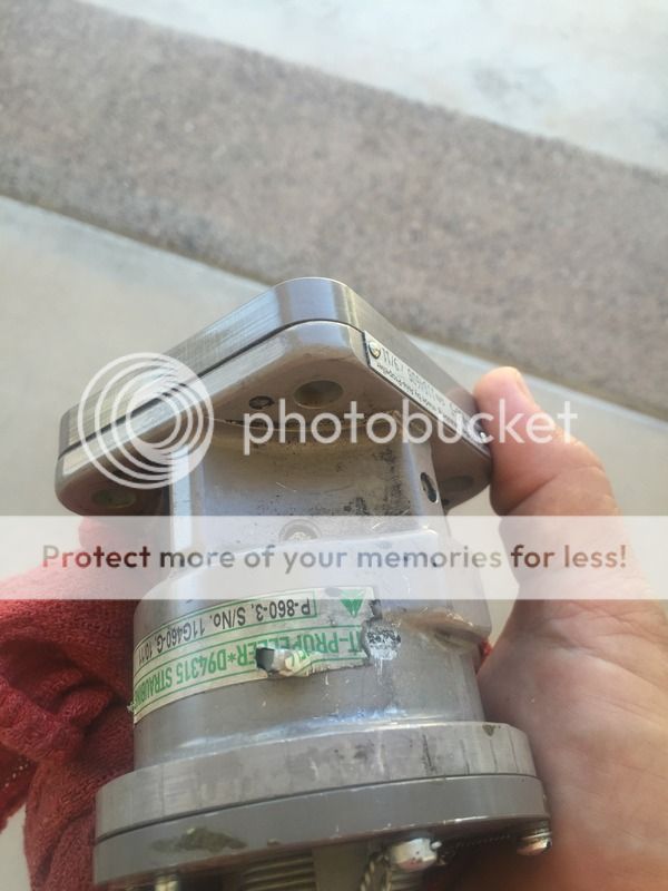

Here I have tried to depict two different failures with like orientation. Obviously the data sticker is oriented differently.
Mine (bottom) appears closer to the lever side and slightly more to the right at punchout point. Still remarkably similar.

Quick update after dozens of phone calls.
This is what I know.
1. Three failures in short succession all in RV-10's with the same model P-860-3 unit and sold by Van's.
2. Two breached the case, one didn't.
3. Two went to overspeed condition, one, (mine) went opposite to coarse pitch. Overspeed means automatic full split case inspection. Jury still out on mine.
4. Mine was manufactured in 2011 and was outside of their SB which were 2012/2013 vintage units. Don't know on the other two.
5. MT in Florida first said that they had never seen a case where the casewall of the unit was breached. They now have pictures of all three and are going to "get with the manufacturer and get back to me". The tech did confirm that the failure could result in fine or coarse pitch depending on how the eggs got scrambled in the failure. I am going to call Germany tomorrow.
6. Two of the engines were built by Barrett. Alan is aware and working the problem. Third engine was not built by him. At this point I think BPE's involvement is purely coincidental.
7. Van's is aware and concerned obviously. I suggested at the very least that they have an alert and/or banner on their website that this has happened. (while thinking emergency AD in the back of my mind) The answer was that more things have to be determined before that level of action but they are actively engaged.
8. The multiplicity of this has only come together, for me at least, through this forum. Who knows how many similar events have happened in other models of aircraft. After 35 years of flying, I've seen a lot of AD's and SB's for stuff way below the level of what these three failures constitute and the potential danger. The insidiousness of this issue is that you don't know you're losing oil until it is gone.
I hate the thought of outsiders invading our world, and I am not a nervous Nelly, but personally, I would not fly an aircraft with this PG until more is known and this is resolved.
One thing that I will add is that I get what experimental aviation is all about and that we exist and are successful because we all absorb liability for own misfortunes.
However, this is a now at least a three peat failure of a CERTIFIED part, each one of which sold carried a chunk of liability insurance cost for just these types of failures that we paid for ourselves in the purchase cost.
I'm not looking for anything other than being made whole and for preventing something like this from happening in the future with, God forbid, less fortunate results.
This is a good opportunity for a real forensic examination of the root cause of this failure (*assuming* all three are truly related in cause).
Analysis of the failure and determination of the failure mechanism, especially examination of the metallurgy and fracture faces of the internal failed parts, will be important. Additionally, operating data from the engine monitors may help.
If these are "certified" units, it surely seems that in the interest of safety, a formal investigation is warranted. If not, and a responsible agency doesn't initiate one, it will be up to the interested parties to attempt an impartial analysis.
There are labs that specialize in this sort of work. May I suggest that if the units have not been disassembled yet, and if the FAA or NTSB are not interested, that the parties consider preserving the units until an agreed upon lab is chosen for an analysis. Knowing that a particular part failed is less important than knowing why that part failed (metallurgy, fatigue, manufacturing induced stress, poor design, etc.).

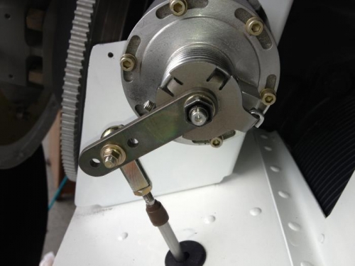

I am currently in the middle of swapping the MT for the Hartzell and this is not proving to be easy. The control arm location is totally different and it looks like I will be talking to Hartzell in the morning.

Rob,
Hartzell has a control arm extension that you need for the RV-10. It's about a $30 part. I don't have the part number handy, but Hartzell will know what you need. There are several three or four year old threads here that discuss the need. Van's supplies the Hartzell governor, but not the required arm.
