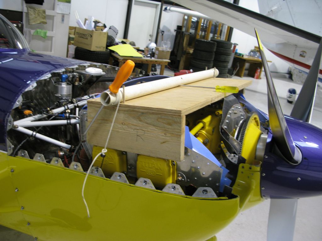

Man, y'all make this sound so complicated! In 1260-ish hours and lotsa oil changes I've never had help or a contraption to drop the lower cowling by myself. Screws at the bottom, pins on the sides; screws out, pull the pins, lower the cowling and pull forward with just two hands, easy peasy, no scratches.

I have a 7A and agree with John in the previous post. I do find it easiest to remove by myself. (Every time someone tries to help it just makes it harder.)
First I fold back and tape all the associated rubber baffling to keep it from catching anywhere. Then I stand on a chair in front and sort of lean over the spinner so I can spread the lower cowl in order to clear the side firewall hinges. Once the hinges are clear I just move it down (back low) until it clears the spinner. Then I just slide it out the front.

If you have Skybolt fasteners on the firewall then this method will work. I use copper clecos in the Skybolt fasteners.

Never had an issue with the lower cowl. I take out all the hinge pins, unscrew the bottom screws and sit on a small stool with wheels so I can scoot around the cowl and gently work the lower cowl away from the engine. It will eventually just fall into my lap. I just take my time and it only takes a minute.

I built a table out of plywood and 2x4ís for legs. Swivel wheels on the end of each leg. Make it big enough to easily set the lower cowl in.pad the table and add blocking or whatever as needed. I have done this for 2 planes and have never had to ask for help with the cowling. I think it is safer for the cowling and plane than borrowing help from whoever you can capture for the task.
