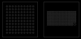

Let's have some fun.
Consider the two filter grids below.
The first has 100 holes, all equal area. We'll assign 1 = area, so 1 x 100 = 100
The second has 196 holes, each of which has half the above area, and one additional hole with twice the area. (196 x 0.5)+2 = 100
In other words, they have exactly the same open area.
Which one filters better? Which one looks bad when tested under ASTM F316?
The filter with the big hole will catch some smaller particles, but also let some larger particles through. I would postulate that over time, the one with the big hole would have liquid with smaller maximum particle sizes.
If testing is "single pass", and the thing tested is "max particle size that got through the filter" then the first filter would be better.
If the engine has a target max particle size that can be in the oil, and the #1 filter will block that particle size, then the #1 filter will be "best". If the engine does not care if big particles get through from time to time, then over time, the particles in the oil filtered by the #2 filter will be smaller.
Correct. The overwhelming majority of the oil (like 96~98%) is being filtered through the smaller holes. The remainder may pass a larger particle, but statistically, that particle is unlikely to hit the big hole when it comes around on the next pass.
Now, which filter grid can be made to look bad with an ASTM F316 test? Why?
The second one, because it can pass a larger particle through the big hole.

I'll bite, though disadvantaged as have not read the ASTM report. 2 obviously filters better, if by better you mean captures more particles smaller than #1's pore size; they are relatively equal in capturing particles larger than #1's pore size. #1 tests better (though how much better would depend upon the viscosity of the liquid being filtered as well as it's surface tension characteristics) due to the larger pore size of #1 and with #2 creating all of the issues that small pore sizes create, none of which help with desired fluid flow characteristics. That is the balancing act; filtering smaller particles requires more compromise in flow characteristics and vice versa. Therefore, accepting a large enough particle size to pass in order to achieve desirable flow characteristics or filtering smaller particles and engineering around the negative flow characteristics, some of which (e.g. bypass) actually make filtration performance worse.
Again correct.
K&P quote: "We use the ASTM test because it offers the smallest amount of manipulation of the testing process."
Reality is the ASTM test is an inappropriate standard.

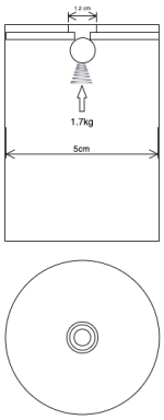

Which brings us back to K&P. What is the opening pressure for the ball-type pressure relief bypass?
Couple related questions, just to give myself some assurance that using the K&P S15 isn't a careless attempt to save money at the expense of safety:
1. Given that the FAA has given it's blessing to the Challenger filter as a suitable replacement for the standard 48108 and 48110 filters that most of us use, is the argument over the opening pressure for the ball-type pressure relief valve bypass merely an academic argument? Or, is the better question...
2. Are we instead debating whether the S15--what is widely believed to be the non-certified version of the Challenger--perhaps has a different opening pressure for the ball-type pressure relief valve than does the Challenger that might make the S15 an unsuitable replacement?
No argument or debate, at least not yet. No one here seems to know the opening pressure. I've sent an inquiry to Challenger.
I measured the force needed to open the bypass ball, and it was about 1.7kg. The ball is about 8mm in diameter (hard to measure exactly) and it looks like about 6mm is exposed.
The math gives me about 48 psi, so I guess that is differential pressure between the two sides of the filter.
Mickey, you sure about that 6mm diameter? Sure looks larger in the photo you posted previously.
I'm not sure if the sun will come up tomorrow! :)
I've attached a drawing of what it looks like - very accurate numbers using a kitchen scale, and the little lady's sewing tape measure. The size of the ball and the amount of the ball exposed externally is not that easy to measure.
Constructed a test fixture to capture the crack pressure on the K&P type 15 filter, results were a slight dribble <20, > 20 psi the ball became unseated and flow occurred.

I see that the bypass opens around the 20 psi. I'm not sure what the other aviation filters open at but on the automotive end this appears to be somewhere in the average.
Really nice work Don.
Ballpark, the range is 12 to 15 psi for the bypass built in to a standard Lycoming horizontal adapter (use a 48110 filter), and the same for the bypass inside a Champion or Tempest 48108, as used (for example) on a B&C right angle adapter.
Auto filters can vary; assume nothing. The Wix 51515 (NAPA Gold 1515) opens its bypass at only 7 to 9 psi. I think makes it a questionable choice, in particular with 50w oil, where it's probably bypassing a lot when cold. If you wish to use an internal bypass auto filter and your application will accommodate some additional can diameter, look at a Wix 51601 to get a 13 to 19 psi bypass. Look at a Wix 51647 if no internal bypass is desired, i.e. it's going on a standard Lycoming horizontal adapter.
I don't think there is any issue with a 20 psi bypass in the S15 screen filter. I assume the manufacturer is confident the element won't collapse at less than 20 psi, so the worst case is simply unfiltered oil flowing through the bypass if the screen should clog.
