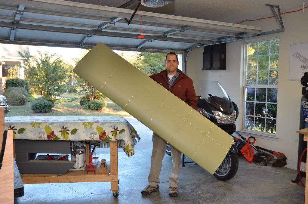

Originally Posted by 60av8tor View Post
Second leading edge complete. Getting close to proseal time
That's impressive Jon! Do you plan to prime all the airframe inside and out?
Hey Vlad. Yup, I'm priming in and out. I began just doing the interior of the skins, but being in southeast Georgia I saw some surface corrosion on my tailcone shortly after getting it built. I think it was from some sweat that I missed cleaning up (built the tailcone in the middle of summer in my non-a/c'd garage ) but it still made me uncomfortable storing my parts in my hangar unprotected for several years.
MikeH on here is a local builder building a -14. He began priming in/out, and I followed suit.
Jon

You are doing right thing Jon. You should see my bare aluminum after flying for only three years
