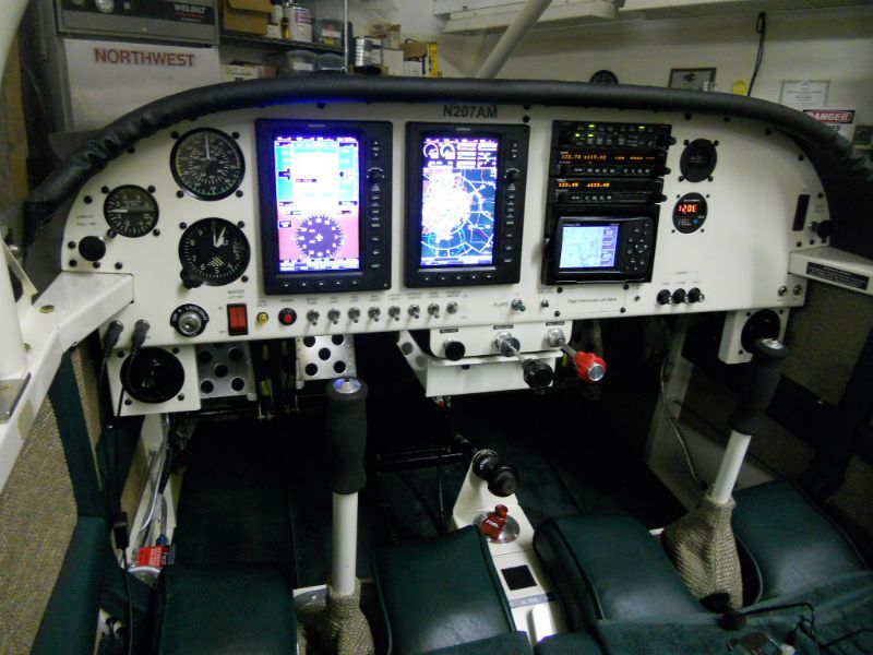

My RV-6 first flew with this panel, in 2000:
Changed it a little in 2010:
Finally built a new panel in June '12:
Mike Hilger
RV-6 N207AM w/G3X, 1,800 hours +
I guess I'm a little bit more critical now than most re interior layouts as a result of being involved as a passenger in a violent RV6A accident some time back. Your new avionics look great but in upgrading it might have made some sense to consider eliminating a few of those quite sharp corners you have in the vicinity of your knees at the bottom of the panel. We aim for the best, but sometimes it's also good to plan for the worst.
I hadn't given it a thought! I went to all the trouble of putting strong padding on my glareshield and forgot the lower panel area. The stuff in the center is clear of our knees but the vents are quite close to my outboard knee. I'll have to look into some changes. Thanks.
