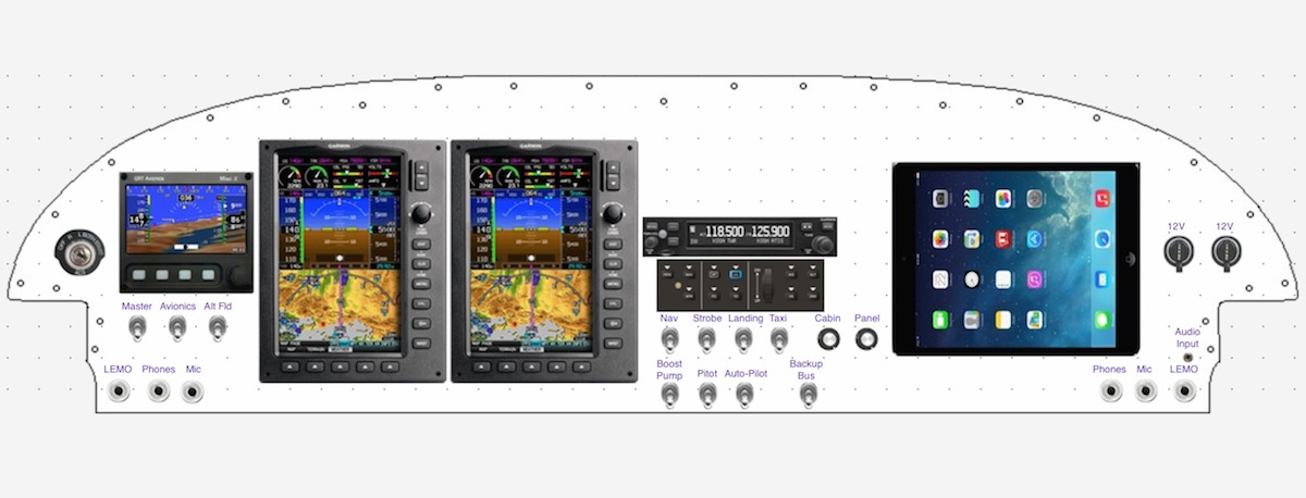

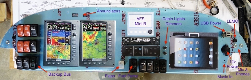

I'm starting the design of my panel, so here's an early prototype.
Some points:
  • It'll have 2 Garmin G3X displays unless they release a single large display soon.
  • Avoiding extending the panel into the leg area any, so it's a little cozy.
  • The RockRack style (APEM) switches take up a lot of room, but I like them.
Still trying to decide whether to mount the iPad Mini Horizontally or Vertically. I'd rather it be mounted semi-permanently to the panel and not on an articulating mount.
Thoughts on the panel?
Thanks!
Russ
Hey Russ,
Boy those switches take up a lot of room.
You will find that while using the G3X with GMC305 a TO/GA button would be nice.
If your intentions are to use the Mini B as a back-up instrument for IFR then more line of sight would be much better.
Most install just to the Left of the PFD. Above the radio stack gets it out of view.
Oops, after looking again I see that you have no IFR nav source so I guess this is a VFR panel. so why then the backup Mini B?

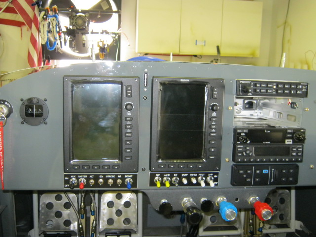

I dont have the GTN650 yet and still have some more placards to make but, this is essentially it!
The VP-X really makes it cool!
The only fuses are for the backup battery.
Best of all, no smoke when I hit the big red switch!
I am gonna love flying this computer!
:cool: CJ
Russ...I don't think you are going to like the iPad that far to the right unless it is angled toward you. I have the rami mounts, which does push it off the panel but it gives the ability to move it around a bit and angle it toward me, which gives better viewing and access to.
Also, you say VFR now, do you intend make it IFR in the future? If so, you haven't left any room for growth in this panel. So you would be starting with a fresh new panel to cut...if you are ok with that then fine. Otherwise you may reconsider this one and leave space for a future (insert you IFR nav equipment) here.
just my thoughts.
Good points Ryan. The NAV upgrade options have been nagging at me a bit. Maybe there will be a remote box solution for a certified WAAS GPS based Nav that can integrate into the Garmin displays. The existing Nav solutions have really tiny displays.
For the iPad... I wasn't going to make it an important Pilot aid. Mostly planning and co-pilot usage.
Russ

+1! Only my opinion, but since you asked... From the looks of things, you could use toggle switches and place them under the G3X screens - same for the switches in the middle. It would then free up the left of the EFIS for the back up Mini B, and free up the center stack for future upgrades for an IFR panel - GPS, second radio, audio panel, etc.
I also second the iPad comment. I LOVE the iPad's aviation capabilities, but the screen is an exercise in frustration in a bubble canopy. I imagine having it fixed - especially at that angle - would reduce it's already sketchy readability in bright conditions. The beauty of the mini is its perfect knee board size.

Here are some thoughts:
1. Don't mount the iPad, they age off too quickly to make a permanent part of any panel.
2. Mount the headset plugs on the sides, below the rail so the wires just drop along your legs and don't get caught in the canopy.
3. Move the flap switch to the right so you don’t have to move your hand from the throttle to raise or lower the flaps.
4. Dump the annunciators, your EFIS will have all you need built in.
5. Go with the Dynon D2 rather than the AFS Mini B. The reason is you can move it around as needed and you won’t take up your much needed radio stack space.
6. If needed, hide the USB ports behind the panel, out of the way and out of site.
7. Install two power ports. You will be surprised at how many things you will plug in to them.
Finally, I don’t know if it is because this is a mock up but your panel just looks overly complicated. Most likely because the switches look like they are sized for Andre the Giant.
Think about arranging your switches by phase of flight rather than function. Thus put all the switches you will need for takeoff and landing close together; taxi & landing lights, fuel pump, carb heat, etc. Starting switches can be grouped together, away from the others so you don’t accidently turn off your ignition in flight. Oh, where are your breakers?

  1. Good point about the iPad's form factor becoming obsolete. I do tend to stay on the bleeding edge of computing.
  2. Exactly where below the rail are you thinking for the headset switches? I was also thinking about placing them between the seats somewhere.
  3. Flaps: Maybe I don't even need a Flap switch on the panel since I have dual Infinity stick grips.
  4. Annunciators dumped. :-)
  5. I understand what you're saying about the D2 vs Mini B, but I already have the Mini B on the way and I really liked what I saw with AFS' other equipment at OSH.
  6. I'll leave the USB ports on the panel for ease of access, with so many devices now USB powered.
  7. I did buy a 2nd Cig Lighter style Power Port. I can add that.
  8. I'm reconsidering the RockRacks more. They'd be fine on a much bigger panel.
  9. Breakers? They're in the VP-X. Though if I have an emergency bus, I'll need a few. Or fuses.

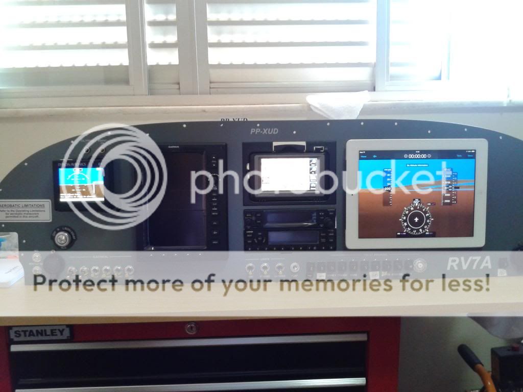

My 7A Panel

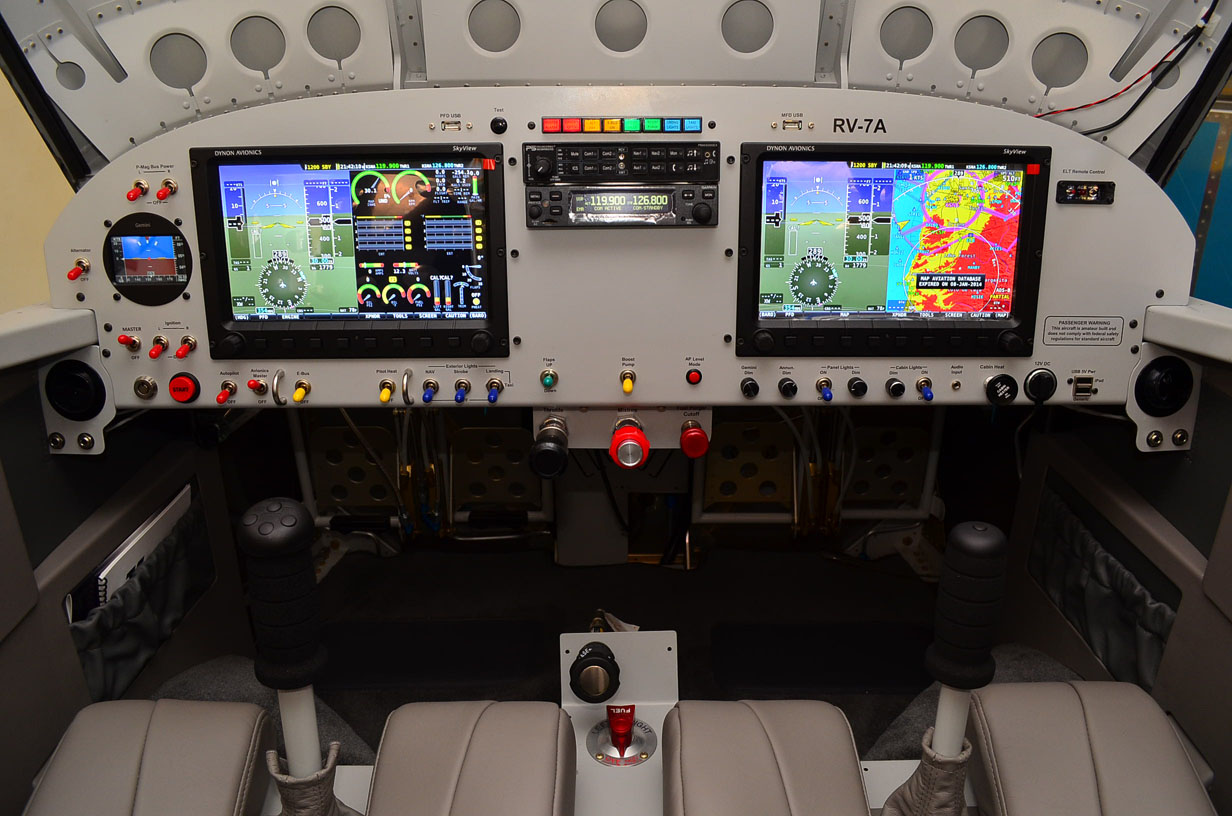

Here is a shot of my panel with the EFIS powered up. This panel has not flown yet but it is getting very close.

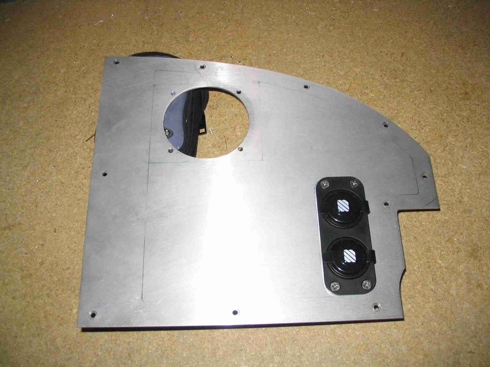

I installed a nice double marine powerport that I bought at West Marine but I cannot find it on line. It looked like a this.
In searching for it, I found this double plug with USB ports that looks it could be modify to fit nicely in your panel (remove the clear cover?). (They also make triple plugs, which wouldn't take up much more space.) Originally I had one plug wired to the always hot bus and one to the avionics master. Later on I rewired them both to the always hot bus and used the breaker on the avionics bus for something else.

John, nice panel. Where did you get the usb connectors about the Skyview? I am about to do some panel updates and would like to add those. Will sure make update the SV maps/software easier.

Taking advice from comments on this thread, here's my panel version 2.0.
  1. iPad mount is still up in the air. I'll place one on the panel and see how it looks.
  2. Replaced big RockRack/APEM switches with standard toggles. I'll install colored boots on them to help signify function. White for lights, Red for Master & Avionics power, etc.
  3. Moved the headphone jacks to the lower corners.
  4. Moved the GRT Mini-B to the left of main display
  5. Now have room for Radio/Nav expansion
  6. Added a 2nd 12V power port
  7. Leaving USB port on the panel, though it's not shown

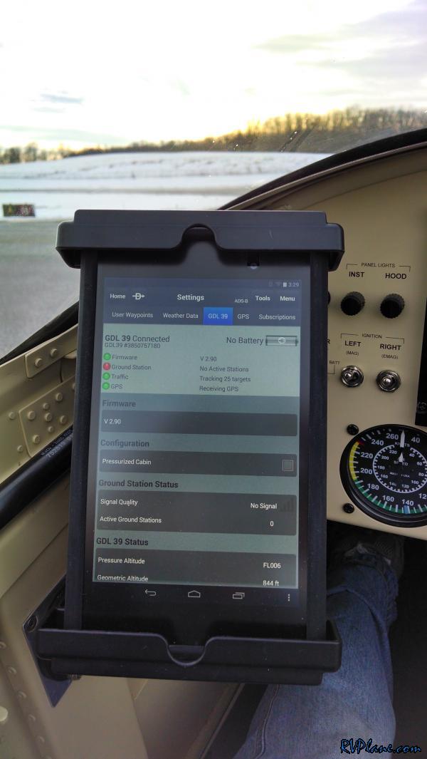

A few things to be aware of with the iPad mini or tablets in general in the cockpit:
1) The iPad mini isn't viewable in the landscape orientation when using polarized sunglasses.
2) The screen isn't all that bright and washes out easily in the sunlight. It also tends to overheat and shutdown in direct sunlight.
3) Being located all of the way on the other side of the panel could make it challenging to use.
4) Tablet technology changes so fast you may not want to commit valuable panel space to a tablet.
I use a Google Nexus 7 in a RAM mount, attached to the F-704K upright cap strip. It works great!
Concur w/ above, and I'll add:
5) Glare is an issue, and flat-to-panel installation may be disappointing.
The aircraft environment was probably not a design requirement; sight angle and interior/exterior reflections are an ongoing challenge.
Articulating mount, and matte anti-glare coating have helped me; YMMV...
