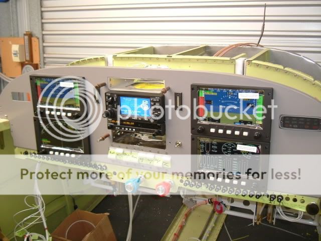

It's been a while in getting to this point, but the project is really starting to feel like a plane now :). Here's my first installation of all of the electrical stuff on the panel. Of course, like everything else, it all came out while I worked on harnesses on the bench. I have the cool 3-lever throttle quadrant, so left the space in middle as a keep-out zone for when the throttle levers are forward. Several smaller holes are for some very nice McFarlane push-pull cables with anodized/engraved knobs. All of that should be installed this week, and the wiring is coming along (I've even gone so far as to learn how to use lacing tape instead of zip-ties for everything...it's very zen-like to make those knots :) ).
I'm trying to have a panel with no labels...everything is self-labelled and the switches are internally lit, etc. I'm after clean, simple and elegant.
(ETA: I had the panel waterjet cut, and then powder-coated to match all the other stuff that Van's powdercoated...best couple of hundred bucks ever spent! :)

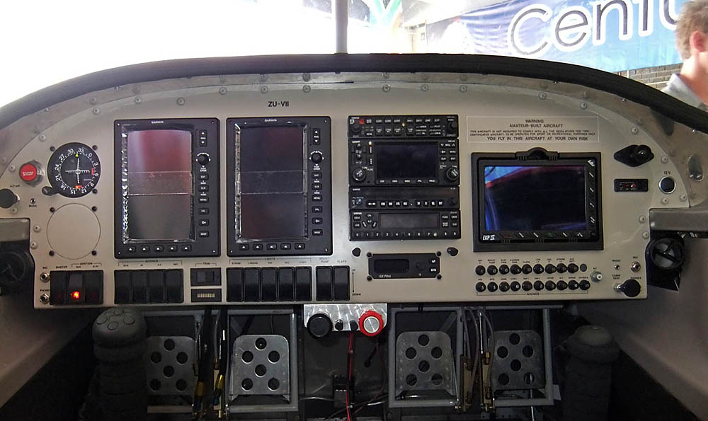

My reworked panel
Hi all, Wanted to put a few pix of my new/reworked panel on here. History... I'm building a 7A and had "finished" my panel, (post 433 of this thread) a couple years ago. As time passed, I liked that panel less and less so... ripped everything out and started over. This is it and I'm much happier with the results. The plane will be finished by the end of the year with the exception on the leg fairings and wheel pants. Looking forward to that first flight and RV grin.
Happy Holidays to all.
Here is one with everything on. No smoke!
This one is with the dome light on. Cool!
Did I mention that I LOVE the I-Fly700!

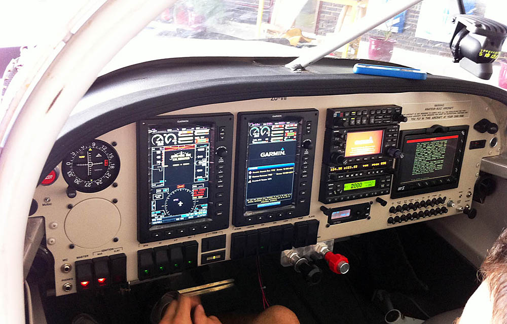

7 panel with VP-x pro
Sig600
Yes, VP-x pro. So far, I really like the control and information. We will see once in the air!
Also:
GRT 8.4 Horizons
GRT EIS
SL30
GNS-430
GTX-327
GMA-240
DFIIVSGV with auto trim
CO-Guardian
TCVR-2 dimmers

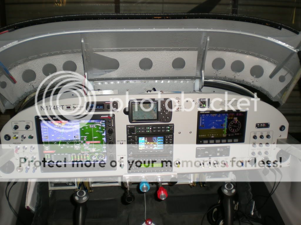

Reassembly
I did not conquer the paint problem, just avoided it.
On second try, my sample wrinkled so I did not topcoat.
Here's the "finished" version (well knowing a panel is never finished)
Digital camera distorts the lighting levels for some reason, making the red flood lights look way out a ballance with the rest of the panel lighting.
Whatever. It works for my eyes in the real world.

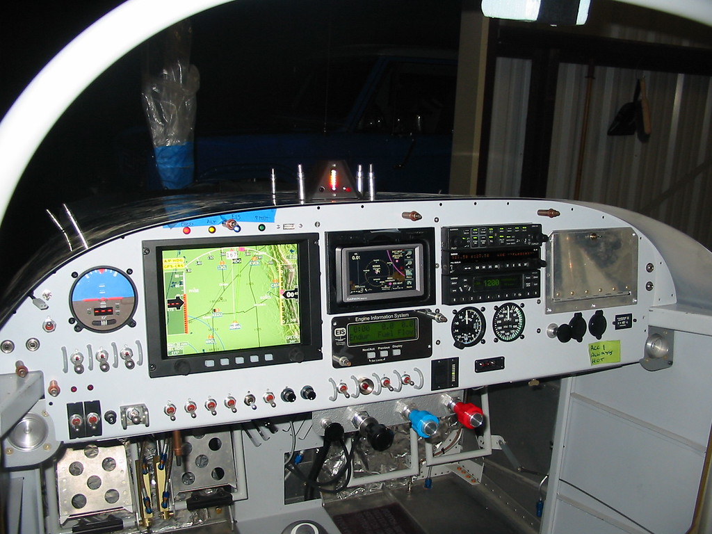

Here is a picture of the panel in my -7A:
The panel is about 1" taller than stock, this allowed the radio stack with the GPSMAP296. The AFS-AP location is not ideal and caused me to remove a small amount of the canopy stiffener. The space between the radio stack and the D100 is intended for a hand held Comm (or Nav/Comm), the two screws just to the right of the 430W are for mounting the hand held.
The switches on the left of the AFS-5600 are generally used on the ground. The switches to the right of the AFS-5600 are generally used on the ground and/or when flying.
The panel is powder coated and the lettering is silk screened. The mount for the throttle/prop/mixture/heat controls still needs to be powder coated.
More details of plane and panel at http://www.vansairforce.com/community/showthread.php?t=81167.

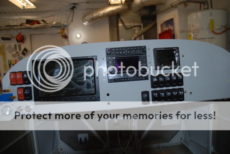

Newbie. Here is my panel (in the works)
Hi Guys, just though I would throw in my few cents here. I wanted to show my panel. It is not populated yet, but soon. Still missing the 2, 7" Dynon displays, and the radio stack is at the avionics shop for wiring. The panel is water jet cut and the display sub panel is hinged so I can access the VPX pro and other things behind the panel. The map box on the right is also custom. The backup instruments on the lower left will be: electric T&B, altimeter and airspeed. The switches are Aveo RockRack.
http://www.mykitlog.com/users/displ...ebro&project=2106&category=0&log=147919&row=2
Hakan Langebro
Simi Valley, CA

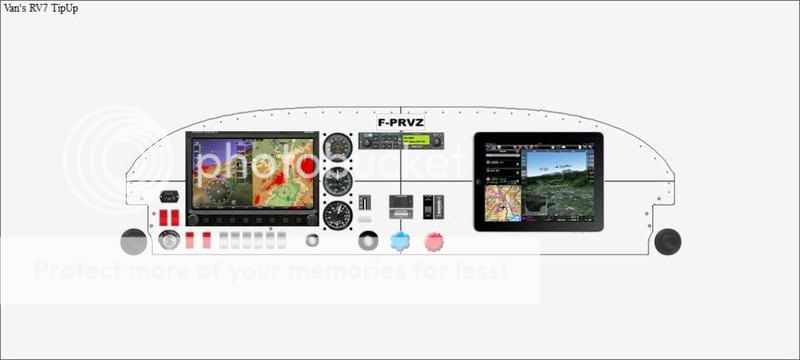

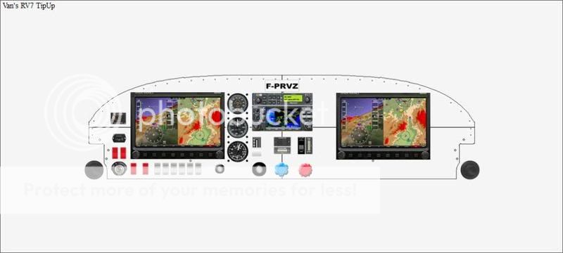

Panel project
Hi everyone,
I bought the licence for Xpanel and I played a bit with the software today.
Here is the panel of my dreams:
Here is probably what I will be able to afford:
Similar, but on the second one the GNS430 is gone and an iPad replaces the 2nd Dynon Skyview.
Tell me what you think.
Important to me is panel symetry, functionality and logic.
On the left are switches for battery, alternator, start and mags. Below the skyview are switches for avionics master, fuel pump and misc switches for lights etc.
Symmetry is Important!
I agree, Symmetry is important and so is simplicity. A minimalist approach is great if you can pull it off.
So twin Skyviews is my plan. In my mind - cause I'm still dreaming about my RV7 - it is very similar to yours except I would only have the Alt and TAS steam gauge back ups. Looking at yours if its to scale you could perhaps put the stuff under the comms stack around the PFD and put two gauges under the COM stack - exactly in the middle of course. But love the plan - I hope to do very similar
Cam
