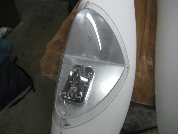

has anyone used the ztron strobes? stats look pretty good but mounting looks like a challenge. i would be interested to see how you handled the mounting.

looks like the mounting hdwe. can be adapted to the ztron lights. i got a feeling i am not gonna be able to leave this alone. i probably will start with a vans wingtip fairing and one strobe . after that the rest should be pretty straight forward.
I have installed the strobe/position lights and two landing/taxi lights on my 8.
Some of the details are in my build log. Click link in my signature below and look in my KITLOG for more details. I am not flying yet, but am pleased with them.

I'm using the strobes, but not on an RV-12.
Easy to mount them in the wing tip cut out.

There was another Ztron thread up at the same time called Ztron pos/strobe mounting so I did not duplicate my reply thinking you would see it. A search of Ztron will bring up more.
For what it's worth:
