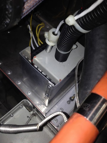

After discussing the issue with Mike who repacked his own repaired unit, I decided to do nothing. Three reasons, first because the adequate fillers are sold in large quantities, they are expensive; second although the filling material is somewhat heat conductive, most of the heat is created on the other side of the PC board and it is clear that the filler is not intended at transferring the heat to the surface against which the Regulator is secured ; third as it will be my back-up unit, I will just make sure that it is sealed to prevent dust and humidity to come in. Once re-installed in the current location (the active unit will by then be in the cooling tunnel) I will seal it with high temp RTV. Once my active regulator has been relocated and tested I will run for a few hours on the stand-by to check that it can play its back-up function satisfactorily.
Follow-up report: I installed my replacement Ducati VR under the panel shelf per Van's suggested location (see John Peck's excellent earlier posts and pictures re: "Relocate"). There was no way I could (or would desire to) run the thick, shielded alt/gen power cable through the existing throttle/choke/heater cable firewall penetration hole - there was no room for it, rubbing/wear looked like a potential issue, and the hole was already well-sealed with firewall sealant.
I used a Uni-Bit to drill a new 0.75" hole through the firewall just under the existing throttle/choke/heater cable firewall penetration hole. Installed a grommet with a 0.50" center hole and rerouted the power cable through that directly to the relocated VR. The other two wires can be rerouted from inside the avionics compartment down through an existing wiring hole to the VR. The existing wires are all sufficiently long to reach the relocated VR. I then sealed the new grommet area with firewall sealant.
Test flight yielded 13.9 volts / 1 amp at 5,250 rpm with everything working (all lights, SV avionics, AP, ADSB, etc.) which is what I expected to see per my past operating experience. :) I was surprised to note how hot the VR gets - you cannot hold your hand on it for more than 5-10 seconds. :eek: You northern folks will appreciate this new passenger knee-cap heater this winter.
My new operating procedure is to delay turning on electrical accessories until just before departure to hopefully reduce the load / heat within the VR (particularly during idle operations) - not sure if that helps, but maybe? Here's hoping my newly-relocated VR is happy for many hours to come.
-- David
ps - I now carry a spare VR - just in case. ;)

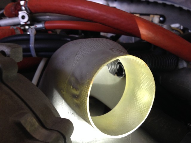

I left my voltage regulator in the original location but attached the blast tube to the radiator duct. The fitting is made from scrap aluminum tube. Slits were cut in the end of the tube to make the splayed legs. Originally I used a rubber "O" ring instead of the safety wire, but the "O" ring broke. The safety wire is not easy to work with without pliers.
Thanks guys for your comments which contribute to the experimental spirit of this forum. Lots of food for thought, here are my own views about some comments:
- About the heat transfer from the contact of the regulator housing with the firewall, if you look at the housing, the eyelets through which it is bolted are protruding which means only the eyelets contact the firewall, not the sides and certainly not the potting mixture as you have noticed it is concave and in recess from the base. While this compound is heat conducting as noted by Mike Miller, its temperature at the surface is not as high as that of the fins and I suspect that the slight space created by the protrusion of the eyelets allows enough air to circulate to provide some cooling. Furthermore, some folks on this forum mentioned that their firewall can get very hot too, particularly in the area close to the regulator because of the radiation created by the nearby exhaust pipe.
- Conflict with the Bender Baffle: I know, I intend to provoke John into a duel to solve the issue :D
- Blast tube off the cooling duct: It was my initial thought but after measuring the dynamic pressure inside the cooling duct at idle RPM, I did not find the pressure of 5mm of water was sufficient to guarantee enough cooling during ground operation.
Getting serious about the baffle, my preference would be to have such a baffle at the air inlet so that both oil and water radiators get the restricted cooling. I hope some crafty guys will come with something like a diaphragm camera. I don't know a lot about John's baffle but I am pretty sure it is possible to have both "Bender Baffle" and "Bernoux Back-up" coexist peacefully as the footprint of the regulator is not that big.

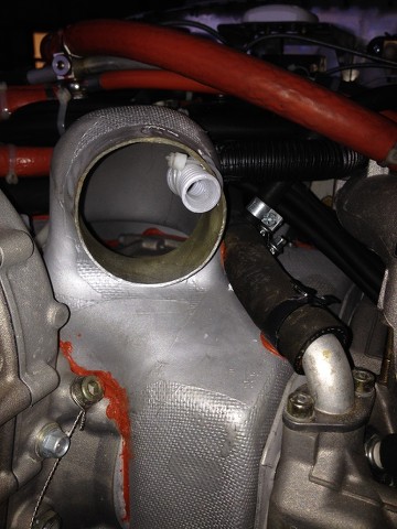

Joe, what did you do inside the radiator duct? Did you let the tube stick out a bit and cut it off in a 45 degree angle to direct air into the tube? Or did you just rely on the pressure inside the duct to allow some air to escape into the blast tube?
I have received my Silent-Hektik regulator/rectifier from Germany and plan on installing it over the weekend while also changing the air pickup to the radiator duct. Interesting about the Silent-Hektik is that the base of the case is flat, milled aluminum. That will allow to use thermal paste to conduct some of the heat to the mounting surface and away from the regulator. Very solid construction all around. I'll post pictures in my blog when I'm done.
No, the tube does not protrude into the air duct. The diameter of the hole drilled into the air duct is the same as the inside diameter of the tube. So it relies on pressure differential for air flow. I made that modification 2 years ago. The regulator has not failed . . . yet.
I thought of another way to hold the black blast tube inside of the aluminum fitting. Strike the outside of the aluminum with a punch to make dimples protrude on the inside. When inserting the blast tube, it will have to be forced past the dimples. Thus no tools or fasteners will be needed to insert or remove the blast tube.

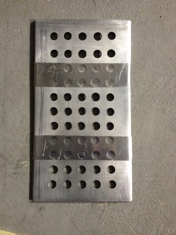

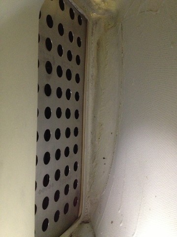

Bender Baffle AND New Blast Tube Scoop
Here is the modification I am thinking of doing. I want to have both the Bender Baffle and to
relocate my existing blast tube to be sourced from the duct. I intend to incorporate a scoop
as shown and not increase the diameter of the blast tube.
I intend to try to get some idea of airflow in the duct on the ground at idle. It makes sense that
it would be much more than through the cowl holes behind the root of the prop blade. I am
going to tape a wooden dowel vertically in the center of the duct, just to the right of the
fishmouth opening. I will have yarn tufts on it. Then with engine idling, have a helper
(carefully - zoomed) take video of what the tufts are doing. If there is a decent amount of
flow, it would seem that this arrangement would provide a lot more ground airflow to the
regulator than that tangential opening on the side of the cylinder shroud.
Comments on the plan are welcome!
