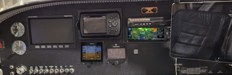

Here is my very similar setup, D-100, GNX 375, Aera760, AV-30. The AV-30 is similar to your G-5 setup but was cheaper than the G-5/GAD29 combo with very similar functionality. You can sell the 327 and the GDL 82 to recover some of your costs. The setup works well, if you get a HS34 the GNX375 will also drive the D180 HSI function as well.
Figs
Figs
Very similar setup. Thanks for posting. I am considering the AV-30 as well but will probably go with the G5 even though it is a little more expensive. I noticed you have alternate air. This is something I don't have. Can I ask how you installed an alternate air system?
