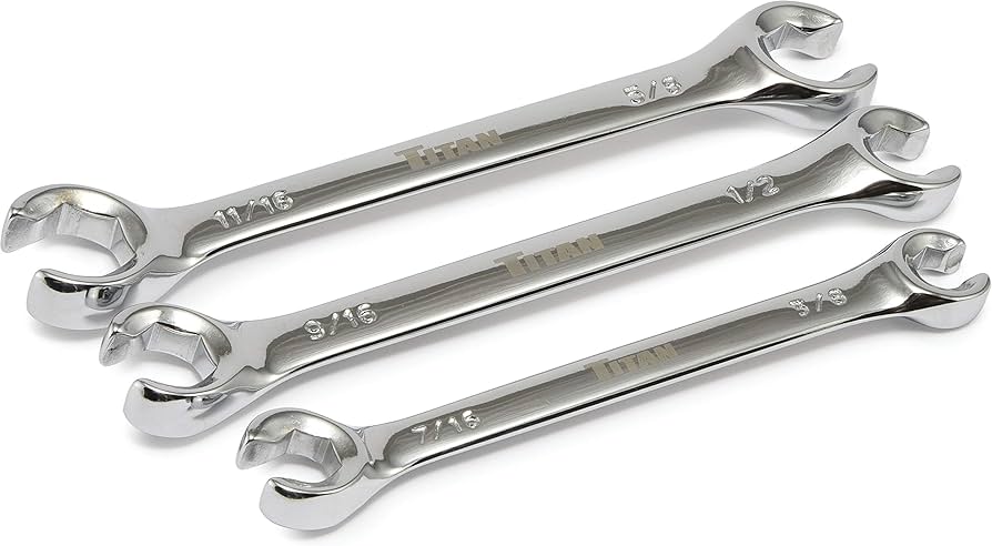

If you're planning to do much work with aircraft plumbing, consider picking up a set of flare nut wrenches, which are less likely to round off the soft aluminum nuts used with aluminum tubing:

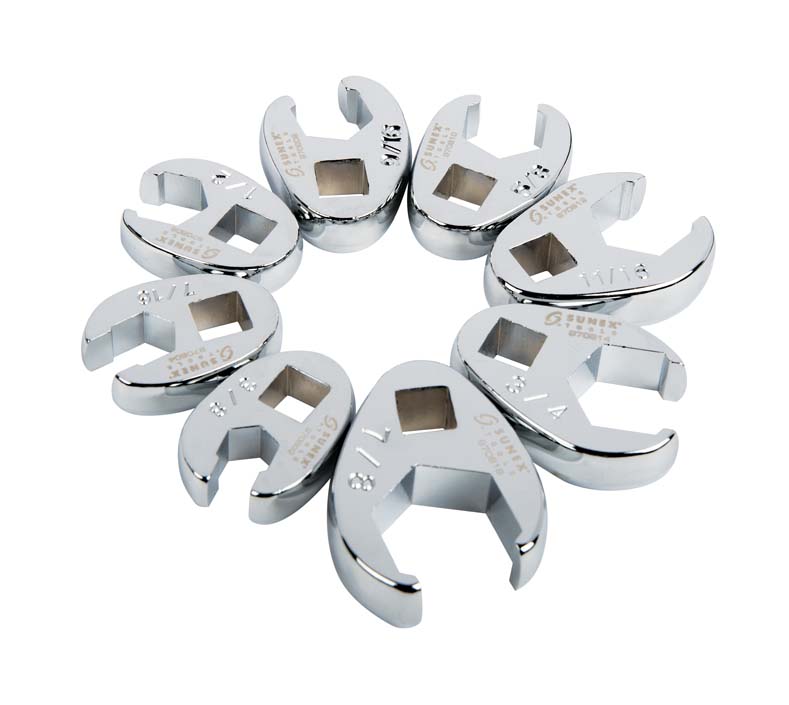

They come in crowfoot form too, which also have their uses:
