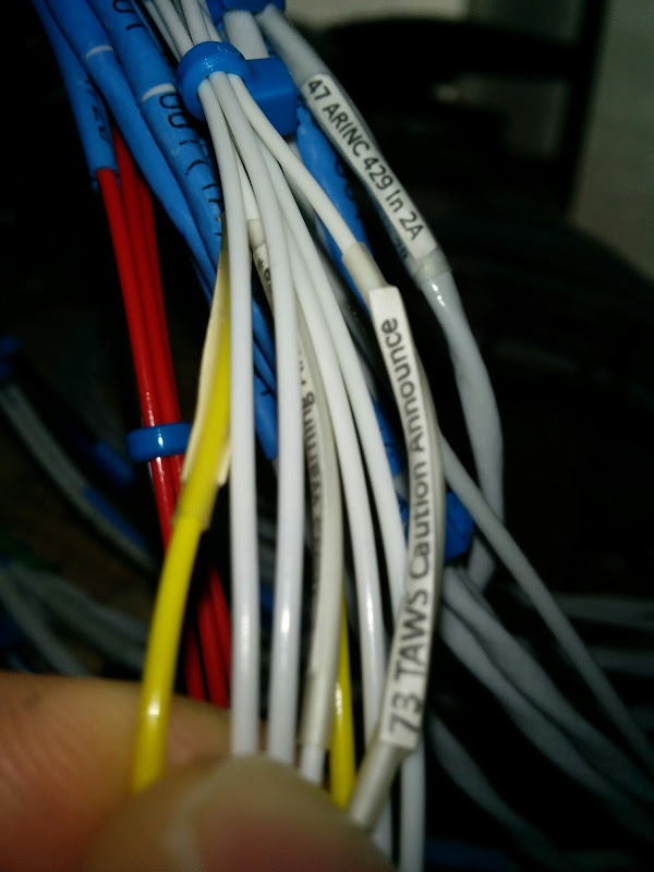

I found using heat shrink printed labels to be best. Identifies the wires at each end/termination in a way that won't fall off with time. Costs a bit more, but well worth it in my view.

I followed a tip I saw on hints for homebuilders: I printed labels in 6 pt font on my laser printer and bought clear heatshrink from Stein Air for about $.30/ft. In addition to the labels, I used colored wires: red for power, black for ground and white for data (per the advice of my Sport Air Workshop instructor) and labeled every wire at both ends. Adding a label to each wire takes less than a minute. That time investment has already paid for itself during construction, and I'm sure it will be worth more when the plane is in operation.

Here is the label maker I have been using and am vey pleased with it. The heat shrink tube labels are a bit pricey but worth it to me. Print them in a single series then cut them to save material. If you print them separately the device will index and waste material.
Brady BMP21
Brady Heat Shrink Sleeves
I bought one of these after much research:
https://labelworks.epson.com/product/lw-px900/
Pricey, but very worth it. Every wire in the upgraded system is labeled with heat shrink tube. It is very easy to do, easy to read and makes things more serviceable down the road.

I first tried printing wire numbers on paper labels with my laser printer, cutting them into small strips, sticking them on the wire and covering them with clear heat shrink tube. This worked but took a lot of time and didn't allow for easy changes when I didn't have the right pre-printed label. So I tried just hand writing on the paper label, cutting and applying with clear heat shrink over the top. This worked, but also took extra time and didn't look as good. Both methods were too fiddly for my liking - just a personal thing.
I ended up purchasing a Dymo Rhino 4200 label maker with black on yellow heat shrink label cartridges in 1/4" and 3/8" sizes. The 1/4" works for most single wires, and the 3/8" fits the 2 and 3 conductor shielded cables. I selected the black on yellow color as the yellow labels are easily spotted on the white wires in a large bundle.
These tubes start out flat, so when you open the tube and put it on the wire, it will hold in place until you shrink it. This allows me to leave the labels on the wires after pulling them, and then to put them into final position and shrink them after trimming the wire to final length for termination.
While this is a more expensive solution than the paper labels with clear heat shrink over the top, it takes me less time, is more flexible, and results in a professional installation. So after all the money I've spent on the RV-10 and high priced avionics, the additional few dollars for this solution is well worth the money to me.

I tried this recently, but found the heat required to shrink the (polyolefin) heat shrink tube was enough to activate the thermal ink on the label stock which made the whole label turn black. How did you avoid that?
I used my 14 year old HP Officejet to print labels in 6 point font, cut them into itty bitty strips, slipped some clear heatshrink tubing over them and the wire then ran the heat gun on it for a few seconds. Very inexpensive.
I don't have a lot of good pics since I didn't bother to document that process, but here's an example:

You may have the wrong type of labeller. I used a unit that consumes Brother?s P-touch tapes and had zero of this happening. I even found that by heating the label itself it kind of melted onto the wire and didn?t need heat shrink (although because this technique often made the text a little blurry, I usually opted for the print nd clear shrink method)

Thanks for all your input. I bought a Dymo LabelManager 160 for 20 bucks on Amazon, and 1/4? heat shrink label tubes. I was concerned that the 1/4? tubes would be too big for 20 gauge wire but it works perfectly.

The 1/4" tubing will do 22 gauge wire. I'm amazed at how much it will shrink.
Here's how it looks... sorry about the spelling :D

I ordered the Epson LW-PX900. It prints at 360dpi and accepts shrink tube cartridges ranging from 1/8” to 1”. I found the best price at an online place called Image Supply. I ordered 1/8, 3/16, and 3/8” black on white tubing. My thought was 22/24 gauge wire, multi-wire shielded, and RG400 in selecting the shrinktube sizes. I’ll report back with pics and a PIREP.
The total for my order was right around $375. OCD costs money! Gots to have a tidy wiring harness. Pahan would be proud... right Pahan?
