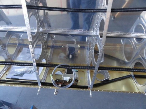

Ok, here's a photo of one of my wings:
Notice I have three conduits. The forward one is trim and wingtip lighting. The middle one is strobe from central power supply. And the aft one, to stay clear of all the power wiring, is for my Garmin magnetometer. In each case, I was able to make the holes for the conduit without infringing on the raised stamping. Ignore the tooling hole and use a drill press to put the hole where you need it. No bushing is required for the conduit, so make the hole the minimum diameter of the conduit and it wont move once installed. This should also answer your question about drilling additional holes for the AOA. Van's does not endorse making additional holes but the reality of installing systems requires us to make careful deviations from Van's recommendation. Keep hole sizes and numbers to a minimum and avoid disturbing the stamping meant to stiffen the part. Others have fabricated stand-off clamp pad and run their conduit through the existing lightening holes, where possible without interfering with the control systems. I hope this helps.
just an observation
Quarter-inch nylon tubing (McMaster-Carr) for Pitot/AOA use nests nicely in the curved edge of the J-channel that runs spanwise down the wing. Might reduce the number of conduits "needed" for your application.
