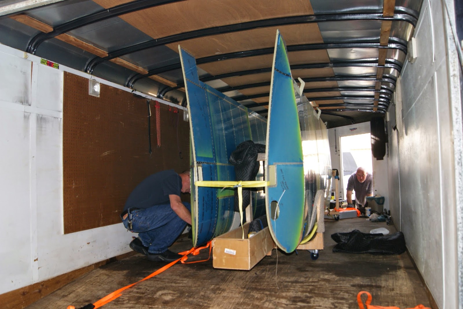

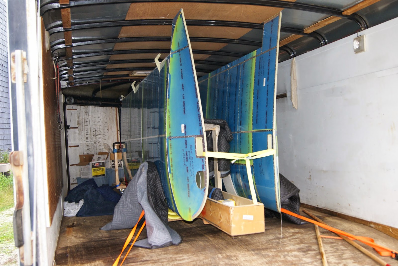

I built a wing caddie using the Van's shipping crate for the spars. Yes, it is long and takes up a lot of room ... but the thing I like about it is the spar crate is slightly longer than the completed wings, so there is no chance of accidentally rolling either the spar root or wing tip into a wall.
The wing caddie was also built strong enough to secure the wings nicely during the move to the hangar inside a friends trailer. The spars were clamped onto the padded cross brace. Below is a link to the blog showing a few photos.
