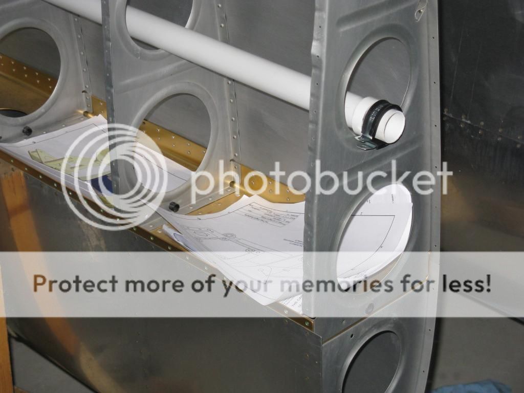

This is what I did
Jeff,
Here is a picture of what I did. That doesn?t make it right, just what I did. I think the PVC is ?? or maybe 1? (make sure it is the thinnest wall available). It is attached to the rib on both ends using an Adel clamp. The wire is very easy to run or rerun after the fact, even with the wings on the plane. However there is limited room between the fuselage and the end of the PVC once the wings are installed.
I also drilled holes in the tube at the point where the pitot, auto pilot servo wire and other things exited the tube (use a grommet to eliminate chaffing).
