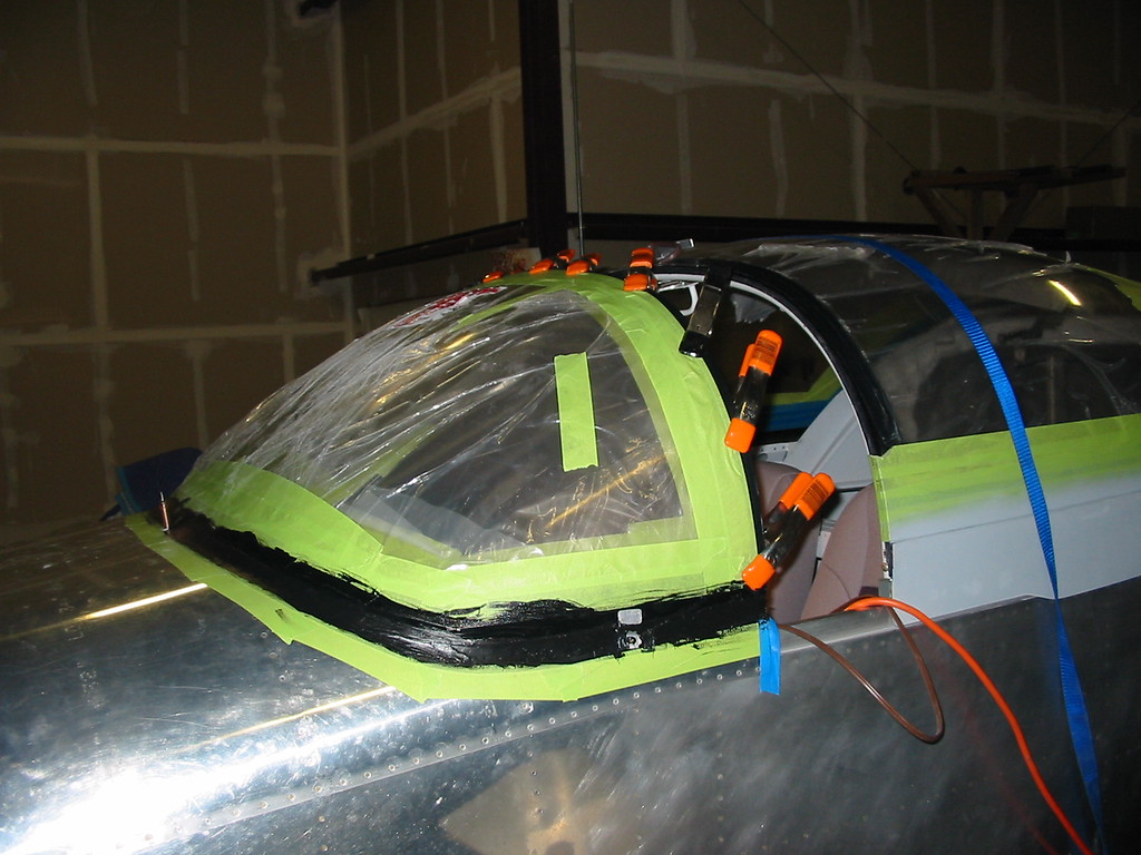

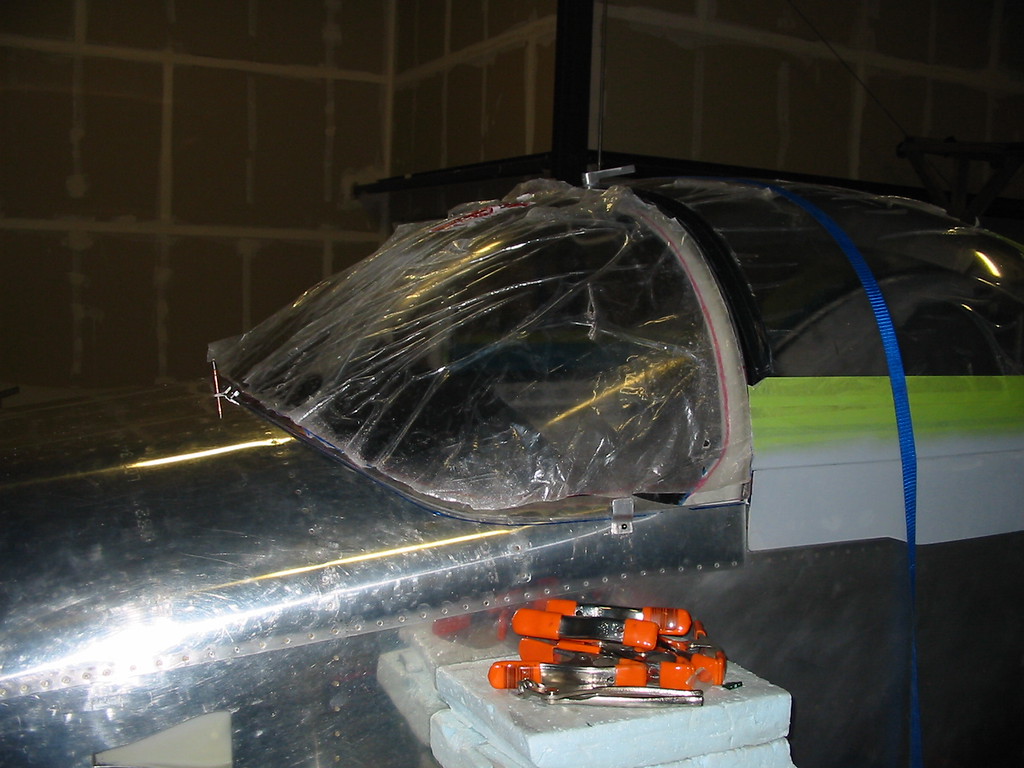

I found a couple of photos. Not great (digital cameras have come a long way since I did this) but maybe slightly helpful.
This one shows aluminum clips I referred to in a previous post. Along with the plastic spacers (not shown here) they were removed prior to glassing. Drilled out the rivets. Unfortunately the gap (done for the requisite compliance required by the Sikaflex) at the bottom is impossible to see here.
First layer of Sika added, clips still visible, can't see vinyl spacers but they were almost certainly there still.

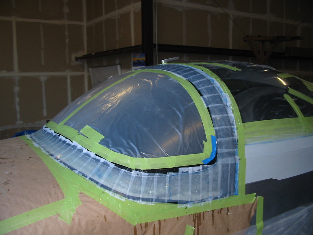

Not sure how helpful this is, but the clips are gone and I've done the first layer of glass. The short vertical strips are peel ply.

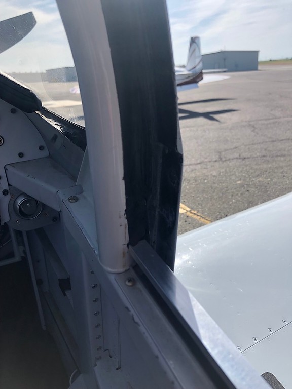

I did apply Sika on the inside. Helps to have long skinny arms and fingers (I have neither). I masked the deck before plopping the windshield down, used low-adhesion 3M masking tape. It was still fun to remove after the Sika cured.

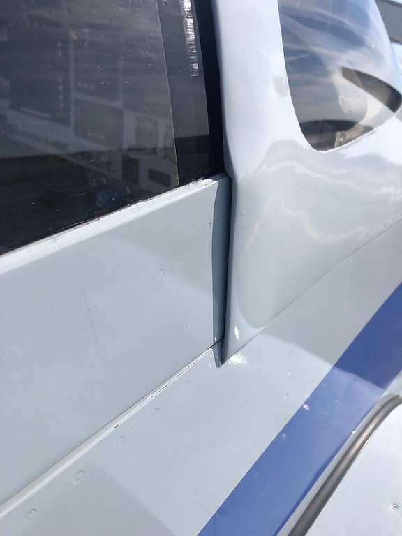

Here are a couple of photos I took yesterday showing the bump I think you are describing:
The above areas are 7 years old now, pardon the grime and scratches.
I bonded the glass directly to the fuselage and windshield. I used Sika primer on all surfaces that came in contact with epoxy (West Systems). I used carbon fiber over the rollbar with a final layer of glass for sanding purposes. Curved and radiused surfaces handle stresses better than abrupt transitions, but beyond that there was nothing scientific about my method other than doing tests with glass/epoxy on acrylic coupons with various substrate treatments including testing Sika primer.
