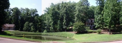

I want to move an extra TV to my shop, and internet access would be nice too. Trouble is, the shop is a bit too far away for a direct connection to my router. Plus there is line-of-sight foliage in the summer.
Obviously I can have the power company drop a new line, but it would be around $60 per month. I'm more inclined toward a one-time cost, notably a WiFi repeater, which as I understand it, would be a device hard wired to my existing router, and mounted on the side of the house facing the shop.
Ok brain trust, it's about 250 feet, with trees. Will it work? What should I install?

I have something from Ubiquiti. I do not understand it well. Maybe ubiquity unifi? Line of sight good aim needed, gets me wifi into my metal building.
I have Ubiquiti shooting 500ft thru Pinetree foliage to its own receiver outside on the other end and then Cat 5 to inside router antenna. I have never tried any TV streaming but the wifi comes thru just fine and picks up the security camera too. Sender plugs into router via Cat 5 and shoots thru inside window, easy to set up. Its the only way my phone can get reception inside an all-metal Butler Building.

250’ is a long distance for wireless. I would think a hardline Ethernet cable would be your best bet. You only have to stick the shovel in 500 times for an underground line. ,’)
From my ham radio days , perhaps a tuned yagi antenna on the transmit and receive antennas pointed at each other might be a possibility.

I set up a link just like that between my house and my mom's house about 350ft away. I cut down a few branches to have mostly a clear line of sight, but if you're working at a shorter distance, you may get away without pruning anything.
On the 'local' side, I have a Ubiquity AC Mesh Pro.
At the 'remote' site, I have a Ubiquity AC Mesh (mainly because it was easier to mount) with an upgraded directional antenna. This is connected to a 'normal' router inside mom's house that acts as the indoor access point.
Also, don't forget to add Surge Suppressors at both ends and make sure to ground them properly.

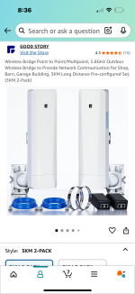

Any simple wireless bridge will work for what you want. Can get on Amazon for pretty cheap. You’ll need a router on each side to connect to your current WiFi, and to provide an access point in your hangar.
This is the one I’m using for my hangar access. $65

I am using a Bridge. Works very good. It is Line of Sight though. Amazon. I have had Lightening to smoke it once though. You will need a wireless router on the shopr end and it is best to hard wire a cat cable from your Modem to the transmitter end at your house.
There is a newer model of this item:​
CPE661 Gigabit Wireless Bridge with Mounts, Dual WiFi Broadcasters, 3KM 5.8GHz Outdoor Point-to-Point WiFi Extender, No Router Needed, Long Range Network Extension for Starlink, Farm, Garage, Barn
$169.99

I got one of these less than 2 foot wide parabolic dishes and pointed it at my house wifi router 400 feet away. Works well for my purposes. No trees. Effectively no windows. One brick wall.

Unless you can add multiple "hops" in a mesh network fashion in between. Based on your image, there is plenty of "nothing" between the two sites however, so you'd need at least power and a pole somewhere.
