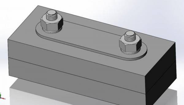

I'm wondering if a thin "sacrificial" plate could be put under the Nord-Locks where there are 2 or more adjacent fasteners. This could work in the same way that safety wire secures two fasteners. Complex shapes could easily be cut with a laser or similar for various applications.
Is there any reason that this might interfere with the proper functioning of the Nord-Lock?
Seems reasonable as long it is impossible for the sacrificial plate to spin, which is what I think you are suggesting here.
Erich
Yes, that's what I had in mind. If two or more adjacent fasteners went through a common joiner plate it should keep it from rotating. Choosing the right material hardness and plate design for the specific application might require some engineering analysis.
One issue I can think of is weight. If fasteners are far apart, this could be impractical. Also, if a hard (heavy) material is needed, safety wire would be hard to beat :)

Realize that what you are saying applies to ANY lock washer, not just Nord type. If the substrate is harder than the lock washer, the washer will not do it's job.
In our hobby, it is normally not an issue as most of the washers are steel or bronze and the substrate is, most of the time, aluminum.
Looking at the Nord website, you can see that they DO NOT recommend a flat washer beneath the Nord washer, as it defeat the purpose of the lock washer...
https://www.nord-lock.com/nord-lock/products/washers/product-guides/
Also, if you look at the mcmaster website, it lists wedge lock washers with a hardness of C46. A typical grade 5 bolt is about C25, and a grade 8 bolt is about C33. Point is, those washers are going to be harder than most of the metals we use in our planes...
I agree Bob about not putting a flat washer under the Nord-Lock, or any other locking washer. I think we're on the same page, but just to clarify for anyone that might have missed what I was describing, here's a visual:
The sacrificial joiner plate keeps the rotation you are describing from happening. It also avoids damage to the underlying structure. As discussed earlier, it would have it's pros and cons though.
