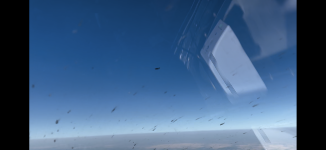

Initial Issue
At about 570 hours the prop started spitting grease on the windscreen. Not a lot, but in about a 3 hour flight it would leave a lot of specks on the windscreen.
Finally, about 30 hours later (after consulting with Whirlwind during this time) I sent it in to JDW props in Ohio - a well regarded service center according to Whirlwind and others - for a rebuild. Was supposed to be pretty straight-forward, and would take about 1-2 weeks and run about $1-2K all in unless there was something unusual.

Initial Issue
