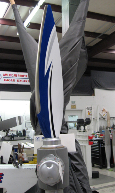

And, finally I asked about custom paint. Bob told me that Whirlwind ships the props to American Propeller in an unfinished state. American does all the finishing. So they can do a custom paint job if you want. I didn't ask about details of just exactly how they'd do the paint job - but - they can do it. Bob didn't make any mention of extra cost but that doesn't mean its free.

Custom Paint Pricing
The Whirlwind web site lists "Custom Paint Color" for $200. American is noted for their very fancy paint jobs that would undoubtedly cost more, but for a simple color change, that should be indicative. Me, I'm getting mine black with yellow tips for the WWII Mustang look. :)
