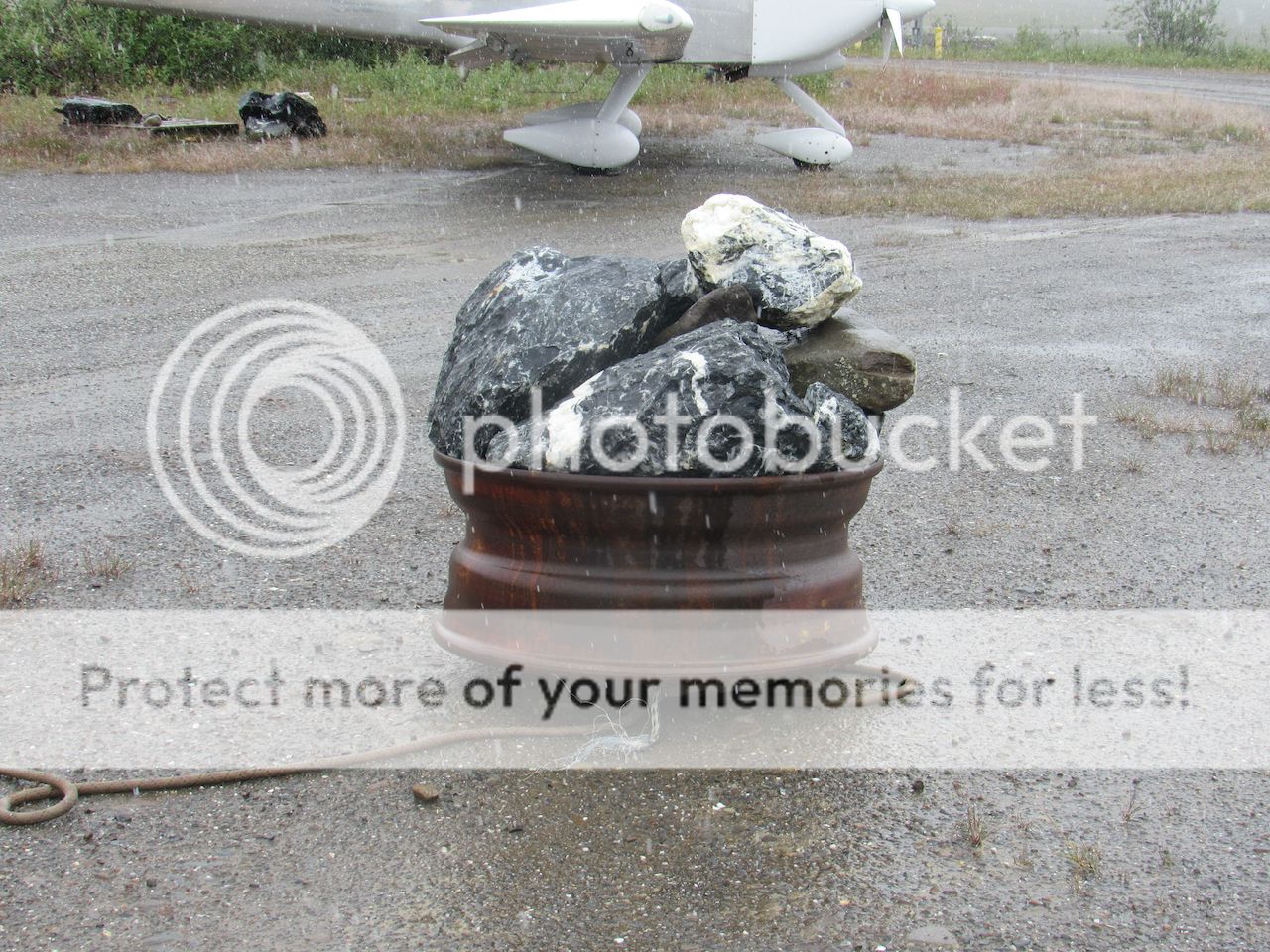

These types are in Toad River Mile 422 in your neighborhood.
And these in Chandalar Shelf of Alaska 5CD.

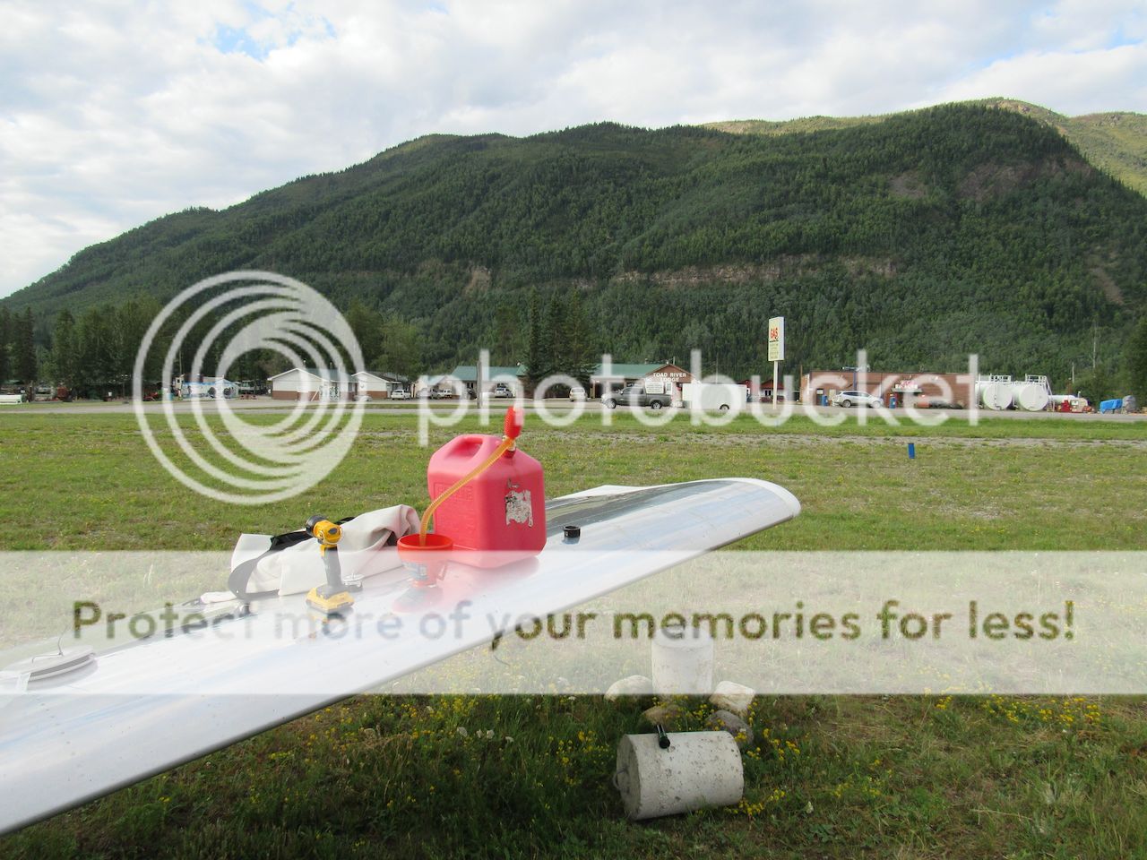

Off topic, but this *kills* me to see this sort of thing...setting tools and whatnot on the wing like that. Ever had a drill fall over? Yeah, me too. Now think about any one of those things putting a nice dent into that nice smooth wing skin.
Do whatever you want, but I *never* use the wing as a tool bench.
