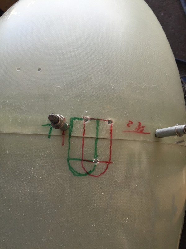

The plans are ok, but, there is a way to misinterpret the plans and make a mistake, and this hopefully will prevent you from doing that.
You are locating a gear leg and brake line cutout in the wheel fairings, and it gives you some reference points. When I first laid out the hole I did it using the green marker in the photo below. I mistakenly used the dimple hole in the fairing as the reference, which is the hole below the cutout in the drawing. This is not correct. This is a hole that is not yet located. So your SOLE reference when marking the cutout is the hole ABOVE the notch you are creating....the one 2-3/16" from the hole along the fairing surface arc.
That is in red in my photo.
If you mix these up, your gear leg cutout will be in the wrong spot. If you do it successfully (I'm glad I caught it), it should fit almost perfectly with only a little filing to do.
I'm sure that 99% of the builders aren't as dumb as I am, so you won't have this issue, but, having that hole which is labeled "mark then match-drill" got me going down the wrong path. It makes perfect sense once you know what you're doing, but if you start using that point as a reference you're doing it wrong. It may be helpful to actually have a sentence in the plans in bold saying to use the upper hole as the reference, or a "do not use as a reference" listed by that hole.
Otherwise, so far the process has been pretty good. I do like these brackets better than the ones on the RV10, and the pre-dimpled fairings make the process pretty nice so far.
