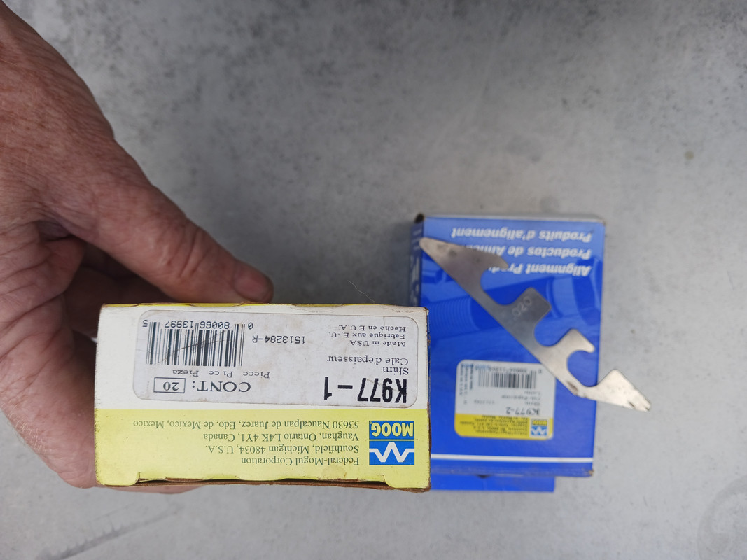

Dan those shims are available through automotive vendors. I know this because I had to change the alignment on one of the rear wheels of my car some years ago. My car is front wheel drive. I'm not at my shop at the moment but when I get back I'll try and find the box and get the manufacturer and part numbers. As I remember there were five or 10 shims to a box. I believe they came in 1/16th & 1/ 8-in thicknesses.
Probably too thick, but a fine idea. In my case a big correction only required a 0.016" shim.

I just dug up the shims. Moog part number K977-1 are .010" thick, 15 to a box. Moog K977-2 are .020" thick, also 15 to a box.
My apologies about the inverted photo. I'm doing this on my phone so I can't flip it around.
