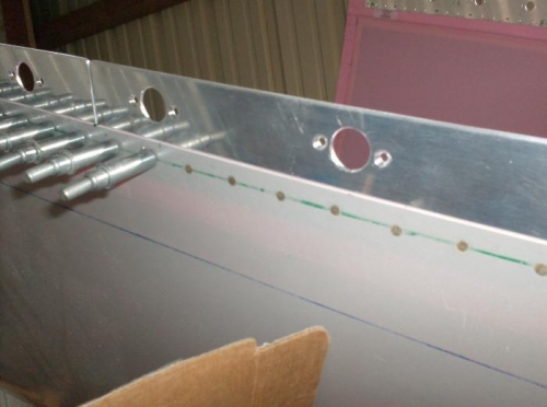

Here is the beginning of my install. Pictures are from my RV-6A install. If you go forward a few entries you can see I made the strips wider than they needed to be. You definitely want to scallop the upper strip so the tabs can be angled to match the cowling. Since the bottom and side strips are straight, they don't need to be scalloped, nor did I find a need to adjust the seam strips (the lower cowling had enough build up for the mating flange that the strips were slightly inside). The strips do not need to touch the cowling inside (except for the seam strips where they rivet to the lower cowl); you'll set the depth of the fastener so a slight gap is actually good.
I used .063 because I already had it on hand. Worked just fine. As for shims, you'll need to test fit and see if your cowl sits proud of the forward fuse skins when it's sitting on the mounting strips. I shimmed mine using the shim material that came in the kit for the hinges.
That's a great tip on the shim material for the hinges. I hadn't thought of that. The pictures here are really helpful. Thanks all!
