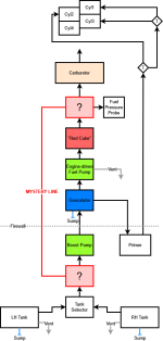

I've been troubleshooting a few fuel issues/questions and I realized I don't really understand the fuel system as a whole. Tracing the lines left me more confused.
I consulted the RV-6A build manual I received when purchasing this aircraft (I'm the 4th owner), but I only see an extremely brief description of fuel hoses, boost pump, primer, etc. and a diagram of "typical fuel / oil hose routing". These resources don't actually describe the system as a whole, such as which component comes after which component in the path.
Anyway, here's the behavior that's puzzling me:
- With the engine OFF...
Flow: If I turn on the boost pump the fuel flow reads 2.0 GPH. Obviously there is no fuel flowing into the carburetor, so this seems to be just 2.0 GPH of fuel flowing around in a circle. This is what initially caused me to start tracing lines, wondering where the fuel was flowing to.
Pressure: However, what really concerns me here is that the fuel *pressure* remains at near zero (0.1-0.3 psi) when the boost pump is on. If the mystery line is some sort of relief valve, I'd still expect full boost pressure.

1. What is the "mystery line" and the devices on each end for?
2. With this fuel system design, and based on the behaviors I described, is the boost pump actually providing any protection in case of engine pump failure?
3. What increase in pressure "should" I be seeing when the boost pump is on?

Without knowing what the mystery question mark devices are it is not possible to answer most of your questions.
What I can tell you is that your system is not typical of a carbureted engine installation on aircraft . Experimental or certificated aircraft.
System pressure with boost pump on and engine not running is usually somewhere between 4-5 psi.
With the engine not running fuel flow should technically be zero but there is usually a small amount indicated because of fuel pulsation in the system caused by the pump. The actual amount varies from airplane to airplane depending on where the pump and flow transducer are located in the system.

That appears to be a poor attempt at a fuel recirculation line. In my plane it is a fuel return line. It tee's off just before the servo, just like yours. It then goes to a pilot controlled valve and then to the left tank. A key difference on mine is that it sits upstream of the red cube. The fuel gets hot in some cases and can boil and create vapor lock or other issues. This is not much of an issue with 100LL in most cases, but is more so with mogas. Mine has a restrictor in the line that limits return volume to about 8-10 GPH, to avoid a variety of potential problems. I mostly just use it after a quick turn fuel stop to flush the very hot fuel back to the tank (it is being replaced with cooler fuel) before startup and leave it open until just before TO. This is the scenario that most have rough running due to boiling fuel. This is less of an issue with carb users, as the vapor created from boiling gets vented once hitting the carb bowl. However, if the fuel in the bowl starts to boil that is an even bigger problem; Good news is that is pretty rare, but can happen. This is why you don't go straight from startup to TO after a quick fuel stop on a hot day if you have a carb. Spend a bit of time running the engine to get that hot fuel out of the bowl and for the engine roughness to settle down.
The design here is poor, as it creates constant recirculation, doesn't go back to the tank where it needs to to get cool fuel, and can't be shut off. It mostly explains your symptoms. It likely has a restrictor in the line. I don't believe it is doing much to help and would either remove it or change it to a more traditional fuel return arrangement. This is making your fuel flow data almost useless.

The purpose of a purge valve and line is NOT to purge air, but to purge hot fuel and replace it with cooler fuel. There is no vent in a fuel pump. That small fitting poking out of it is NOT a vent as you are thiking. It is an exit path from the non fuel area of the pump. If a diaphragm breaks, it will spill fuel into that area. If that area wasn't vented, the pump would stop pumping fuel once that cavity filled with fuel. With that vent in place, a pump with a failed diaphragm can still pump a reasonable amount of fuel even though it is leaking. This is a limp home, safety feature.

Yes, this recirc circuit is going to wreak havoc on your fuel pressure, in addition to the fuel flow readings. Again, I recommend getting rid of it, as mentioned above.

Early model Bonanzas have a fuel vapor recirculation line. Pressure carb models return to the left tank. Later constant flow injected models go thru the selector back to the selected tank.
In this case your issue is where the recirculation line is plumbed to and if it were me I would check the restrictor size and plumb it ahead of the red cube. Would also return it to a tank rather than the selector, which might be a considerable project.
I have flown a number of carbed RV's that exhibited vapor lock on 100LL on very hot days and consider a vapor return line a good feature when properly done.
I would get rid of (or cap the purge line port) of the block closest to the fuel selector valve. Then add a purge valve and tee its output into a tank vent line as close as possible to the tank. Or better, if you are going to work on your tank or tanks, add a fitting in the root rib for the purge line return.

If it was me, I would remove that line and cap the ports. Nothing else for the moment. This will simplify the installation and present you with a couple of options. Leave it be without return line or embark on a plumbing venture and install a properly designed return line.
Run the engine and see what your indicators tell you.
My guess is that your fuel flow and pressure indications will look "normal".
Later you can decide if you want to pursue the installation of a functional return line with expected benefits as described by Ir172.

Your fuel system needs a serious re-do.
I agree.
They look like generic brass tee fittings you might find at Home Depot,
Nothing wrong with those except they are heavy but cheap and those brass fittings are not the problem in your system.
Van sells a similar fitting block made of aluminum.
In the meantime, your plan to cap one end of it is a good first step in verifying what you are dealing with. Make sure you cap both the hose and the brass fitting. For a quick check if you are impatient you could just pinch that "mystery" hose with a large clamp and do a run up before removing fittings.

Posting an update to this fiasco...
Removal of the return line
Yes, I will be removing the fuel return line. But because I don't know what I don't know, I'm going to go the safe route first: cut the line and install a shutoff valve that will be in the OFF position in-flight. I'll fly for a dozen hours, and if I never need the line, I'll remove it.
I spoke with the local EAA chapter, who pointed out that the Facet 40108 boost pump I have (which is recommended by Vans in the original design) is marked by the manufacturer and Aircraft Spruce as "not intended for aircraft use". Supposedly there was a case where it failed in such a way as to block all fuel, resulting in fuel starvation and an off-airport landing. So before I take the return line out completely, I plan to install a short bypass line (with a check valve) around the Facet pump, to ensure it is not the "single point of failure" of the system.
In the meantime, this return line (with a shut-off valve installed) will be the bypass for this purpose.
Waiting on parts from ACS to get this done next week.
Hypothesis about the puzzling flow and pressure readings
Yesterday I had a hypothesis that what I was actually witnessing was pump cavitation. I kept asking myself why am I seeing zero pressure with the boost pump on, when I definitely do see pressure in-flight. If the return line is allowing 100% of the boost pump's flow back through on the ground, it would do the same in-flight.
But I put the main line into a bucket, capped the return line, and measured a full 15+ GPH going into the bucket. Reassembled everything and still saw 2-3 GPH and zero pressure. Made no sense.
I finally realized... all my ground tests here were AFTER I had done my carburetor inspection items for this CI (drained the bowl, moved the throttle lever back and forth to check smoothness and security, etc.). I introduced a bunch of air to the lines! Gravity would have drained the fuel from the lines going back to the highest points. By distance, probably 1/2 of the "circle" was air, while the other 1/2 was fuel.
In this condition, my boost pump would have been cavitating in all my tests, even that last test after using the bucket. Without the engine running, there was nothing to purge that air. This is why I saw only 2.0 GPH and 0.0 PSI, when the boost pump is clearly rated for 32.0 GPH and 6.0 PSI.
Confirmation of hypothesis
After some careful steps to ensure the system was reassembled with all lines purged of air, I now see 2.9 GPH (the flow back through the return line) and 2.8 PSI (now that the pump isn't cavitating, it is trying to push the fuel faster than the return line will allow).
That confirms the the boost pump really is providing the safety net in case of engine-driven pump failure.
