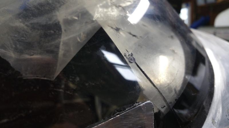

I had a crack in my canopy and decided to fix it as well as I could using the weldon products. I drilled a hole using a plexi bit to stop the crack. I filled in the crack with the thinner weldon #3 and sanded it down so its smooth. I then filled the stop drill hole with #16. I checked it about an hour later and there were little spiderweb cracks emanating from the hole. I had no idea how they showed up. I drilled those out and just filled those holes with the 16 again. 10 minutes later more cracks showed up. I drilled a bunch of practice holes in some scrap and can't get any cracks to show up in the scrap pieces. Why is my canopy cracking when I put the weldon in the hole?
Not sure, but my guess is that the weldon is expanding as it drys / cures. Try filling the hole with epoxy or clear silicone .
Because of the curvature internal stresses are high so its likely because of the holes you've stop drilled. I'm of the opinion that stop drilling cracks usually makes a crack worse. All it does in truth is shows others that someone has acknowledged a crack. I can't tell you how many times I've seen aircraft skins stop drilled with cracks emanating from stop drilled holes.
Weldon 16 is recommended for acrylic products but in fact it is a solvent based product containing a high percentage of MEK. It works by actually dissolving the acrylic. The problem here is that MEK is a double edged sword as it can break down the molecular structure of the acrylic and potentially cause additional stress cracking as you have found. The problem with the Vans canopies is that they are double curvature and the forming process leads to increased levels of internal stresses being locked in. Trying to repair cracks in Vans canopies can therefore be very problematic and is best done by a professional.
My guess is that you are going to end up replacing this canopy or you are going to have to live with something that looks terrible.
Many builders think that using the Sikaflex approach on their canopies will eliminate the problem of cracking but there is mounting evidence that this is not so.

Well I just did some testing with a scrap piece. I bent it a little bit with some clamps to put some stress on it. Under stress even putting one drop of weld-on on the surface makes it developed cracks. Might be considered crazing? Putting a drop of number 3 on a piece that is not under stress does not create any cracks. I obviously still have some stress in that corner where the crack developed. Who knows how far up from the edge the stress is strong enough to continue to develop cracks. I'm experimenting with the scrap piece to figure out what I can get away with before I do anymore on the actual canopy.

It probably is cracking, but at a microscopic level. I did some testing with methylated spirits on formed acrylic some years back. The acrylic looked OK with the naked eye but when I viewed the sample under my Olympus stereoscopic microscope at 30X magnification you could clearly see fine cracks emanating from the affected area. Then, flexing the sample caused the microscopic cracks to propagate by the “work of fracture” principle so that they became larger and visible to the naked eye. The “work of fracture” principle postulates that stresses at the tip of a crack can be extremely high.
In reality acrylic (poly methyl methacrylate) is prone to breakdown at the molecular level by a really wide range of chemical substances, including virtually all solvents.
My best guess is that your particular problem arose because of inadequate treatment of the canopy edge after cutting. The edge was probably not sanded sufficiently to remove all discontinuities at the microscopic level. Most RV builders do not understand the extent of sanding required to remove microscopic discontinuities at edges and penetrations of the canopy. In your case the solvents in the Sikaflex primer probably attacked the acrylic causing a crack to emanate from one of those edge discontinuities.

Internal stresses in materials are often relieved with “annealing”, which is the application of heat, allowing the molecular structure to “flow”. As the temperature rises, eventually the acrylic will melt. Before that temperature is reached, there may be a point where a slow stress relief occurs, without large scale distortion. If this is true, you would think it would be part of the manufacturing process. But even if so, the NEW stresses caused by installation of the canopy will not be neutralized by the previous annealing. So I’m wondering if an application of heat might anneal the new stresses caused by the installation process. I’m not recommending any particular procedure. Experimentation with scrap materials might shed some light on this. Even if positive results are obtained with experiments, scaling it to a whole installed canopy introduces the problems of temperature control, distribution of air temperature, duration of heating, etc. Perhaps relatively high ambient temperatures should exist during drilling, and installation.

Played around with some samples. Bent it with clamps so it was under stress. Put 2 drops of weld on 3 on the surface. Within a minute the surface cracks showed up under the drops. After that dried I heated the piece with a heat gun. I moved the gun back and forth about an inch from the sample for about 45 seconds to a minute. The surface was quite hot to the touch. After it cooled I placed 2 more drops on the piece. NO cracking. I must have heated it enough to relieve the stress and there is no distortion visible in the piece.
I will do 1 more sample then if that is also successful I will heat the corner of the canopy which should relieve any stress in that area. Then I should be able to fix the holes with weld on with no further cracking.

I?d use wet and dry throughout. I?d start off with something quite coarse...say 80 grit. I?d use this to completely shape the edge into a continuous radius and to remove enough material to ensure that there are absolutely no little recesses left in the surface. All cutting techniques will leave little discontinuities (pitting) in the acrylic edge and you need to sand down beyond the depth of the deepest of these. Machining and cutting of acrylic also induces localised stresses so if you sand off enough material with the 80 grit you should also be reducing those local stresses. Then come over that surface with progressively finer grit...say 120, then 400, then 800. If you?re really fussy go to 1200. The more glass-like the surface of the edge is the safer it will be. It?s a little bit painstaking but not nearly as painstaking as getting a crack in your canopy and having to replace it.

David, annealing of large thermoformed complex acrylic shapes such as glider canopies is common practice and is probably the only way to reduce internal stresses created by the forming process to reasonable levels. I have no idea if Vans canopies are annealed....and it wouldn’t surprise me if Vans don’t know either. At any rate the annealing of aircraft canopies takes a number of hours in an oven at elevated and very controlled temperatures. You will not be annealing your canopy by hitting it with a heat gun for a minute. In fact it is possible that by heating up only a small part of the canopy to a high temperature you might in fact be locking in further stresses.
