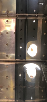

The origin of the noise was the rubber strip on the wingroot fairing, which for reasons that are beyond me suddenly decided to pull itself out of position and beat itself against the fuselage. In my 700 hours of flying RV-6's I've never seen this happen before. This machine has 210 hours and it's never even hinted at moving previously. Strange. I removed all the screws (photo is taken as I was removing the fairing to reset the rubber strip), reinstalled the rubber and buttoned it all up again. My wife went to the cafe and spent up large on muffins and scones which we delivered to the Crash Fire Crew and Air Traffic Controller by way of thank-you, then we headed to Mossburn for a much needed brew. After a couple of local Cheese Rolls (a southern delicacy) and a pot of tea we flew the final 35 minute leg home via the Nevis Valley to another greasy landing at Cromwell. Aside from the rubber popping out the journey had been fantastic and the scenery was just beautiful.
