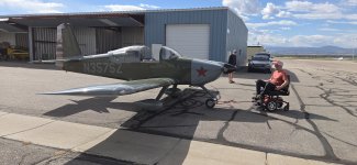

A bit late to the party, but here's my tug. Photo is Caleb Marsh (Transition Trainer) pulling his 7A all the way from the hangar area to the tie down area. Probably 1/4 mile.
I plan to take it apart and turn it into a dedicated tug. This was a quick attempt to see if it would move my airplane.
Mobility chairs are cheap. Medicare buys new when a patient needs one so families have difficulty selling them. I recommend a Jazzy Elite HD. It's the highest capacity chair money can buy. It's a tank. Very modular and easy to take apart.
I just made a hitch to attach to my Bogi Bar and added a 1-7/8" ball. Works pretty good pulling, but difficult to steer pushing. That's why I plan to break it down.

Larry, Funny you should mention this. I just bought a Jazzy Elite HD yesterday. It was for a great price with new batteries & knobby tires. You're correct, it's built like a tank. Much bigger than I had anticipated. It's still on my truck & I have to figure out how to get it off without a ramp. Taking the seats off will help by reducing it about 50 lbs.
I suspect a longer, stiffer towbar would make a lot of difference. Works that way with golf carts.
A more stable attachment to the fork would also help. A Bogi Bar is pretty sloppy on the pegs. The towbar below was built for a tailwheel, but the principle applies; it clamps on tight.

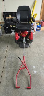

I built an adapter for my new Jazzy tug to repurpose my bogi bar. I mounted it into the square tubing that once supported the foot pad.
I was able to try it out today across grass to my concrete slab & it worked great. No need for a steering handle as the remote does it all. When traveling, I can disconnect the bogi bar & use it remotely. Later, I'm going to the reuse the square tubing I removed, to make a more permanent adapter. But for now, it's working fine.

Just a heads up. The setup was too long from the pivot point & it created a jack knifing on the copper stem adapter. It was way too soft to absorb the jack knife. I'm looking at a welding option closer to the unit. I should have it in a few days & will share the info.
Just a heads up. The setup was too long from the pivot point & it created a jack knifing on the copper stem adapter. It was way too soft to absorb the jack knife. I'm looking at a welding option coser to the unit. I should have it in a few days & will share the info.
Mine is a 1-7/8" ball attached to the square steel where the foot rest is attached. The hitch has a pipe inserted into the Bogi Bar. I think it's too long, but maybe I just need more practice. The ball and hitch works, but keep your legs away from the bar if it jack knifes. That hurts!
I left the chair intact to sit in it while driving. Downside is I get a really mean looks from some folks. Upside is the kids love riding it!

I went through many iterations of using the Bogert bar, short, long, heavy bar, etc. and finally threw in the towel. I ended up designing a fork using 1" sq tubing and welding it to the adjustable bracket for the foot plate. I tried a bicycle cable to actuate the fork but it kept failing, I switched to a linear actuator, it works great. I had some drawings I created but have not updated them since the original design, breaking my own rule.
I also added a handle to allow me to put pressure on the wheels as the floor is slippy, it also aids in steering. With a little practice I have been able to get the RV backed into the hangar without jackknifing.

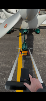

Lightweight travel E-tug 3D printed around a compact winch motor/wheel for what my 6yo knows as airplane robot.
Can you post more info on your tug? It looks nice and I think a better design than what I built. Thanks
Hi, sure added the only other pic have taken. Just not much else to show- atv winch wired to handle mounted pmw. About 30-50% power is fast enough and powered by a 20ah LiFe. Basically press down on handle about 20lb and lever action provides good tire grip. With the tight/rigid tubes, steering is same as with my Bogi bar and spent slightly less with all new materials.
