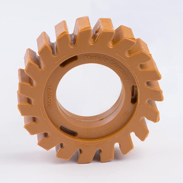

Spruce has this. I have not used it, but it looks like it might do the job.
