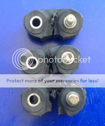

There have been some failures of the 110 rubber drive couplers/ spiders/ pilot bearing inside relatively short hours. Possibly another case of insufficient TV testing.
Apparently there is a new design on the 130 engines but it hasn't been out that long to know how it will last.
The photo of those rubber drive couplers is scary. As a decades-long Honda driver I have tremendous faith in the basics of Honda engines. Our son has a Honda Fit which has proven to be absolutely bullet-proof in every respect. As a result I dearly want the Honda Fit engine to succeed in aviation. In fact, I have access to a Fit engine right now that I'm considering purchasing just to have in reserve in case a suitable aircraft project comes along.
It's such a shame that Jan seems, once again, to have conducted far too little testing before going to market.

It might be appropriate to add that when these rubbers fail, the airplane still makes power to the prop and flys to a safe destination, and replacement rubbers are very inexpensive and easy to install.

What is the story with the destroyed soft element? Where can we read more about it?
Yahoo Group- Viking Aircraft Engine. This is an independent group not controlled by Jan although Jan sometimes posts on here it would appear, defending and promoting his packages.
