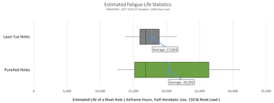

I only watched the short form presentation video. I feel a lot more confident that my RV will withstand the test of this novice builder and the test of time.
The screen grab is the chart is what I was looking for to find out the residual strength of the airframe after over 10,000 hours on an airframe that has been subjected to an airshow aerobatic load for 1/2 of its life. The single highest rivet load is still less than the residual load while the rest of the airplane is a lot less than this. I don't fly my RV this hard or fly this many hours if I fly for over 20 years.
I think you’re using this term incorrectly. “Residual strength” refers to the strength of the structure after fatigue cracks form and grow. Until fatigue cracks start growing, the strength of the structure (even after many thousands of hours of aerobatics) does not go down (unless you have corrosion, or impact damage from hail, or other problems).
What that graph shows you is that, if a rivet sees ~150 lbs of load during each limit-load event (e.g. 6g pull-up), then you can expect fatigue cracking around that rivet possibly as soon as 13,000 hours (with all those layers of conservatism they talked about: loads purely in-plane with no prying/peeling, the lowest outlier e.g. most poorly manufactured hole out of dozens tested, and more aerobatics than anyone realistically does, i.e. In real life it would be a lot more than 13,000). And that 150-pound number represents the most highly-loaded hole in an RV; All the other rivet holes see loads that are at least slightly lower, so they can go many more hours before fatiguing.
Edit: In other words, that graph does not show “strength capability decreases over time”. What it shows is “Depending on how much of the strength capability of each hole is realistically needed - and, for most holes, it’s not much - here’s how many flight hours you can fly before there is any deterioration in strength in the material around that hole”. If most holes only see 100 to 120 pounds of load - and that, only during a 6g pull-up - then the material around those holes should be able to last well over 100,000 hours before they show any sign of fatiguing, according to the graph.

I think that some of their analysis went as deep as to know the exact rivet that would have maximum load throughout the flight scenarios.
could Vans publish the locations of the highest load rivets for each of the models
This was shown in the video. Screenshots attached. And: Reminder that they pointed out that the relief notches on the flanges see higher stresses than the rivet holes.
for any given repeated load, the bulk of LCP parts had a reduced life compared to most of the control group.
This is not true. I would be curious to know where you got that from. The video said and showed repeatedly how the lowest outlier was lower for punched parts than for LCP. Sure, the average for LCP was a little lower, ok. But you should care about the lowest outlier much more than you care about the average or about the "bulk" of parts. Do you care more about how many flight hours until the first hole in your airplane fatigue-cracks, or about how many flight hours until 50% of the holes in your airplane have fatigue-cracked? (That's not a rhetorical question. I think we would all agree "The first hole"). If you keep that in mind, then the graph with the error bars (also attached a screenshot of that below) basically says that LCP are superior from a fatigue point of view.
