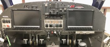

I have the standard single G3X VFR pannel. What would be the minimum equipment needed for IFR training?
Practically and realistically, you’ll need a certified GPS navigator. A 430W would be an excellent value choice, giving you a nav radio as well.
