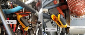

Now that PlaneKool is working so well, I’ve been venturing into warmer locales where pre-A/C, I just didn’t bother to fly. But now, oil temps are making regular excursions to 225*+ F. I set up a test by using my Bluetooth HVACR refrigerant line temp probes to measure oil cooler (OC) inlet/outlet temps and compared those to indicated on my G3X. During warmup, I saw that the OC inlet was measuring within 3*F of indicated, which gave me some confidence of the BT probe’s accuracy with the less-than-ideal clamp arrangement on a hex nut. Found that indicated temp was only 6*F cooler than OC inlet temp and that there was 16F delta of OC inlet/outlet, indicating the Vernatherm (VT) wasn’t doing a good job. Problem found! Or so I thought…

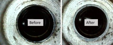

Vernatherm Seat Repair
Installed the new VT and flight-tested it. Not a huge amount of improvement (7F delta of OC inlet vs indicated, where previously it had been 6F). Thought about it and went back and looked at the 2008 VT and to me the seat was possibly leaking at the VT cone. I had checked the VT seat in the engine with a (low-quality) endoscope before I replaced the VT and it looked OK… however, after inspecting the 2008 VT, I saw the cone didn’t have even wear on its face. Time to clean up the seat per that same SI 1316A. The tool called out to remachine the seat is available to buy for… $2100! You gotta be kidding me… fortunately I had a couple of dead VT’s available, so I made my own from one of those plus $40 of parts from McMaster and 10 min on a lathe.
Cleaned up the seat and checked for any loose chips and went for a flight.
Results were better, but still not where I thought it should be, with 11F inlet/indicated delta. Time to do some more thinking…

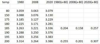

I had truncated my chart because didn't think anyone cared about the coolest temps... below is the whole chart starting at 80F. The oldest ones start almost identically in length even with the big gouge in the oldest. And I can't remember where in the groove the ring gage sat. The new one starts .020 longer at 80F.
I did not measure OAL. And, I got my required length to seat the cone from SI 1316A. Where did you get yours from?
Looking at your measured lengths, your VT appears less good than my original 1980 one, which didn't actually pass, looking at the chart. Attached the raw data too with the lengths subtracted from 80F so you don't have to squint at the chart. ;)

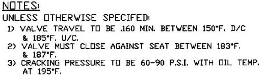

Dan, at what temperature is the measurement on the drawing of the VT depicting?
The line drawing includes a caption stating "0.160" Min, Travel Ref". As I read the drawing, it means a cold vernatherm should measure....
3.280 - 0.160 = 3.120"
...from the underside of a nominal 0.0625 thick sealing washer. I note all of Heinrich's vernatherms measure a bit short of this dimension at 80F. However, ring gauge sizing and any cone wear would complicate the measurement.
In a separate spec list, we have:
"Valve travel to be 0.160" minimum between 150F D/C and 185F U/C."
and
"Valve must close against seat between 183F and 187F."
I have no idea what is meant by "D/C and U/C". And I apologize to all about second hand data. The Rosta drawing was provided by one of their engineers under an agreement not to publish the document itself.
and

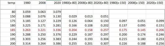

Note in my 1st post the pic of the height gage zeroed out on the sealing washer. That is how the OAL dimension is specified and is how I measured them. Dan notes that all my measurements seem short at 80F, but that is only because he assumes the .160" travel downward from the design length at 185F is a spec, which it is not.
Below I've attached my measurement table with some added columns of length deltas at 80F and 150F starting temps. You'll see that my 1980 VT passes the .160" test but fails at the design length at 185F. (it actually moves .175 from 150F to 185F).
SO, based on all that verbiage, what to do for the average guy without a height gage? Well, it would be fairly easy to make a GO/NO-GO gage from a fender washer with a .560" hole placed on top of a 1.5 ID tube, 3.530" length. You'd cook the VT at the 185F spec and then quickly put it on a flat table, hex base down, and then place the tube over the top of it and then the washer on top. If the washer rocks, the VT is long enough. Drawing below.

I think it's time to step back and analyze our long-held assumption, which is that if the valve moves .160" from 150F to 185F, it's OK.
Good point, and your measurements prove it.
Works for you and me, but the fabrication might be too much for the average builder without a lathe and/or suitable reamer. Within the degree of precision required, wouldn't an ordinary caliper be sufficient for overall length at 185F, measuring to the wear line on the cone?
Good point. Looking at my length table, even that old 1980 VT would pass the length test at 190F, but not at 185F.
And the new 2020 VT grows .095" between 180F and 190F, indicating you need to be fairly precise with controlling water temp if you want an accurate length test. Looks like a good excuse to get a sous-vide cooker if you don't already have one!
