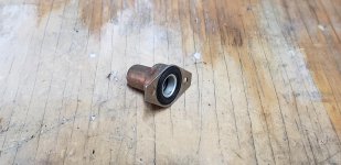

Where do you recommend that we install the nut plates? Are you suggesting using screws instead of the pop rivets on the baffle? I’m right at this point.
Nut plates
Sorry, no. NAS1473A08
They take the place of the standard nutplates for the Access Panel. Since they're sealed, the screws don't need proseal. They have an integral rubber seal but I prosealed them and added proseal around the outer edge. My Mentor gave me the tip.
