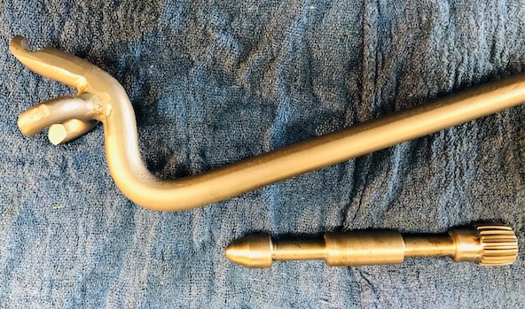

Started on our IO-360 angle valve valve wobble test today and used our new ATS spring compressor. The unit is adjustable but we spent at least an hour on the first valve trying to get it adjusted where it would compress the spring evenly (i.e. not cocked) so the keepers would come out. We finally managed to get the springs off but then the adjustment that made it right for getting the keepers out was completely wrong for compressing the spring back to get the keepers back in. Think I'm going to send these back and get a "Valve Wizard" Am I doing something wrong?

Yep, I sent the adjustable one back and ordered the valve wizard for my Lycoming angle valve engine. I thought about it before ordering the other but the "injected molded" generated thoughts that it's plastic and won't hold up. I've since learned better.
Ya it does seem like it might not hold up, but they specifically call out to make sure and use all the screws and tighten them evenly. It seems to be fine after using it a few times. and it's just so EASY. My A&P spent way too long with one of those pivot lever types before we pulled the wizzard out :)

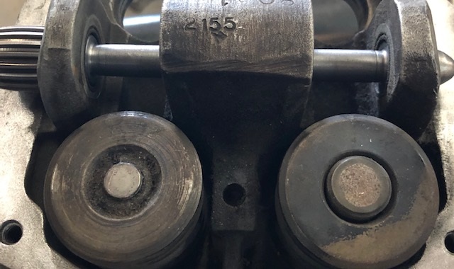

I made a valve wobble test tool that also compresses the valve spring. Not the best tool for removing a valve, but a very good tool for doing the wobble test, as the fixture both compresses the spring (allowing measurement of valve movement in the guide) and eliminates the need for removing the spring and retainer; though it can be removed. It was modeled off the Lycoming version of the test tool and you can follow the SI instructions for using their tool. I made two and sold the other here. I would be willing to make more if there is interest. I sold the other for $100.
This is for parallel valve engines only.

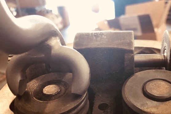

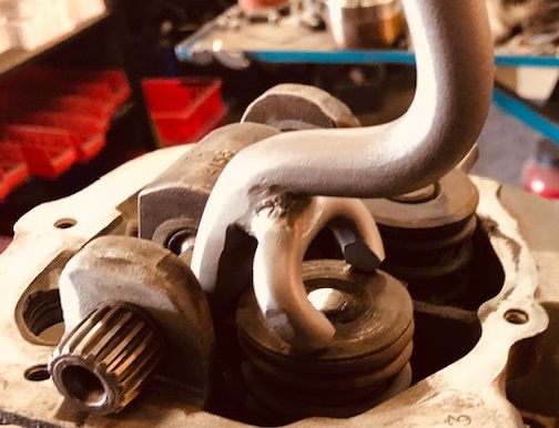

Found a great valve spring tool
I wanted to share a great tool discovery for anyone needing to work on the valves.
I tried to make a spring compressor tool out of pry bars. Grind, file, more grinding.. it turned out awful. I threw it away in frustration.
Then I came across the tool pictured. It's Snap-On S-8675. It was made for 1950's truck and tractor engines, but the design is absolutely perfect for the Lycoming valves. Very heavy, well made, forged steel tool. And it doesn't cost the crazy amounts being charged for valve spring tools, such as on A/C Spruce. It worked great - highly recommended!

Another recommendation
I've tried using a p/n 12-21520 tool but had difficulty on some cyls because you need a short enough pivot pin to get it in there past obstructions on the baffle. Had better luck with two P/N 12-03227 which attach using existing rocker cover / baffle attach holes. They're designed for rocker shaft removal using one on each spring but I made them work for getting the retainers out on a single spring by putting two on opposite sides of a spring. That les me compress the spring evenly, and keep it in without needing a third hand. I did end up getting a couple of full-thread hex head bolts to use in place of the ones with the knurled knobs as those tend to get in the way. YMMV, just an alternative to offer.

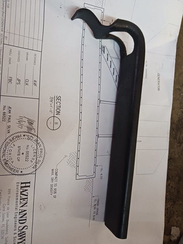

While digging through my tool boxes looking for a brake cylinder hone I stumbled upon this [KD Tools] KD-910 valve spring compressor. It looks very similar to the Snap-on unit that you recommend. They go for between $20 and $25 used on eBay
