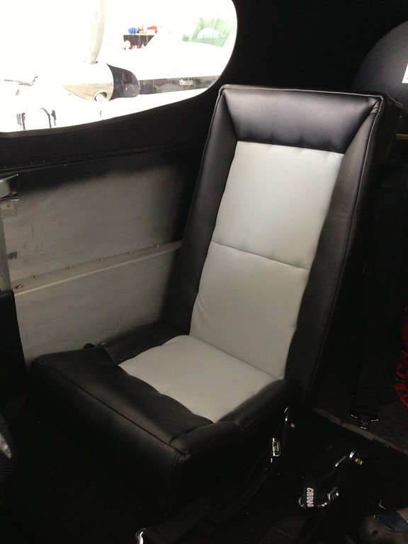

I need to know how people are upholstering their back seats using the Vans catalog foam. Do they look like my -6A, a cushion just on the front of the seat and a seat cushion with velcro to the floor? Or do you completely cover up the aluminum seat and wrap the covering all around the seat? Or what other ways do you do it?

My seats were done by Geoff at Aerosport Products. Geoff does a fantastic job on the seats. He charges a bit more than the competition, but I think he also delivers a great value for the price. Give him a call and you'll understand why.
My seats have a sheet of aluminum to make the back smooth, then is covered with carpet to match the carpet in the baggage area. Unfortunately, I don't have a photos online showing the back.

For the bottoms, I completely covered them and carpeted under them.
For the seat backs, I made covers similar to a pillow case. They are open at the bottom and slide down over the foam AND the aluminum back support. The bottom seat hides the bottom of this pillow case design.

My interior came from Flightline Interiors. Abby does very nice work using quality materials. She has the rear seat foam from Van's in stock. When she upholsters the rear seat foam, its glued to the material. You just open up the Velcro in the back, slide it over the stock Vans seat back frame you built in the kit, re-Velcro the back and install the seat back using the hinge pin per plans. The bottom seat is just Velcro-ed down to the seat pan.
