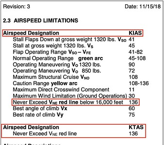

... This snippet from Page 2-3 of the POH shows Vne as 136 KIAS below 16,000', but also shows 136 KTAS with no qualifiers. Are we to assume the 136 KTAS number only applies above 16,000'? Can you clarify the Vne speeds?
Hey there Carl - good question. :)
First of all, the short version is that one should never exceed either speed (136 KIAS at any altitude or 136 KTAS above 16,000ft). Obviously those speed numbers can be anywhere from "significantly different" to "close to the same" relatively speaking - depending on altitude, temperatures and other conditions.
Slightly longer version: The IAS limitation is a limit intended to protect against structural concerns. The TAS limitation is there to protect against flutter concerns. Both are important. They're not the same, and only one is the primary limiting factor in any given point.
Even longer version: I just learned some very cool (and new to me) engineery stuff, since I asked our (way smarter than me) Chief Engineer about this. Basically, you'll not be surprised that we've done a lot of testing of the RV-12iS (and our other aircraft). Through all that testing we determined that the limiting factor for the 12iS below 16,000 ft is indicated airspeed - that's what defines that portion of the safe-tested "box" on the graph. Once you cross above 16,000 ft DA, the limiting factor becomes true airspeed.
We test the aircraft structure on the ground to certain load limits. The IAS limit in the POH is there to protect against overloading the aircraft (gust loads, dive loads, and loads applied by the operator).
The TAS limitations are related to protection against flutter. We of course test to speeds higher than are printed in the POH for loads as well as for flutter. As an aircraft climbs it will reach an altitude where the risk of overloading the aircraft is no longer the primary concern -- and in those conditions the primary speed-related issue becomes flutter. In the case of the RV12iS, that switch of primary limiting factor happens at 16,000 feet.
It should be noted that both the Garmin and Dynon EFIS systems can only report one number on the airspeed tape. To be conservative a single TAS value was chosen for EFIS Vne at all altitudes. In reality we wanted to give you that part of the envelope back (to allow you to descend faster) but to do that we'd need two Vne numbers on the airspeed tape. The only way to communicate the additional portion of the available envelope was in the POH. We hope in the future that EFIS manufactures will accommodate Vne based on a combination of both true and indicated airspeeds.
So -- never exceed either one, but true airspeed doesn't become the limiting factor before about 16,000 feet. In reality, our published limits get even more conservative once you cross 16,000 feet. The math becomes complicated when you need to decide which speed is primary in real time so we simplify it a bit, in a conservative manner. And calculating all that in your head while in a dive at 17,000 feet... Forget about it. :)
Disclaimer: I'm not an engineer - not even close. I marvel at those who are and geek out on the conversations I have with them. So, I very likely have described things here is a much-less-than-perfect way.
But hey, I learned something and had a good time doing it. :)

Greg,
I'm a little confused by the Vne (Redline) limits shown in the RV-12iS POH. This snippet from Page 2-3 of the POH shows Vne as 136 KIAS below 16,000', but also shows 136 KTAS with no qualifiers. Are we to assume the 136 KTAS number only applies above 16,000'? Can you clarify the Vne speeds?
Thanks for clarifying "Maximum Wind Limitations 30" by adding the words (Ground Operations).
