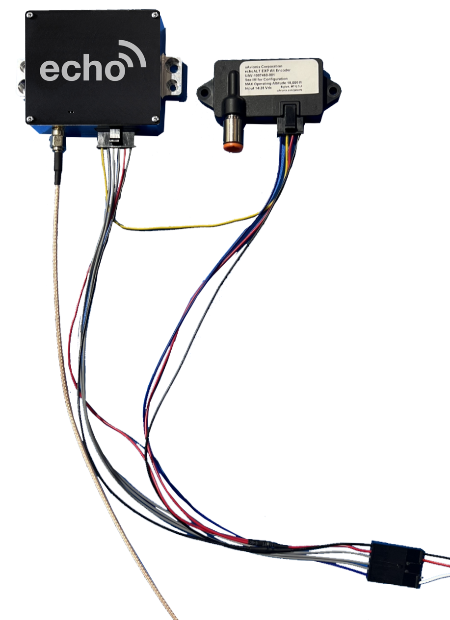

Has anyone installed it to the front of the Echo UAT? I made a little bracket on the 3d printer to mount it on the front but havent installed it yet. Did it impact your WiFi signal? I am guessing no, but figured I would ask.
I put the EchoALT right beside my Echo. I hope I did not mess up. Read my earlier post. However, I think it was me.
Darren
