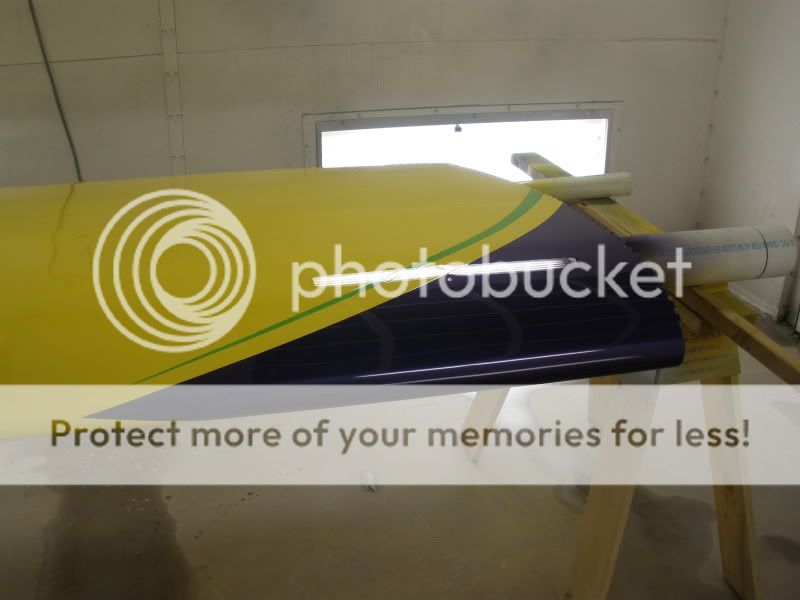

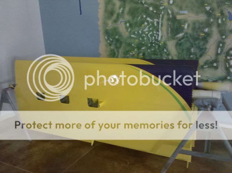

I know the wings on a -10 are substantially different than those on my -6, but I built a rack for my wings. The stub spar on the inboard side sat on horizontal beam and I inserted a piece of large diameter PVC pipe through the lightning holes at the tip and set it on a horizontal beam at the outboard end. The PVC extended all the way to the fuel tank, and the rack held the wings in a nose down configuration.
It worked very well. Not only did I transport the wings 15 miles to the airport in that fixture, I also stored the wings in that fixture for years (before and after paint).

I don't know about the 10, but on my 8 I slid a large 4", i think,PVC pipe through the rib lightening holes near the fwd spar and supported each end, Also slid a 1 1/2 in PVC through near the aft spar secured it and carried on.

I transported mine laying flat one at a time on pads in the back of my truck. Then I hung them on saw horses until I was ready for them. One end was supported by the spar stub the outboard end I used a long piece of PVC pipe stuck in the lightening hole. This leaves the painted area free to cure.
The PVC method also works well for painting. 2 people can roll them over easily

Mine were painted in a heated booth, and had a weekend to cook, then a few more days to cure before transport. My painter said they should be fine, so I just laid them on blankets in the back of my pickup. Of course, I only transported them about 5 miles so it was pretty brief. Once at the hangar, they went back onto the rotisserie stands that I used to enable painting. No problems.
