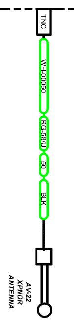

C Catbird Well Known Member Oct 9, 2023 #1 Can anyone tell me the overall length of the Transponder Antenna Cable, WH-00050? Thanx!
rcarsey Well Known Member Oct 9, 2023 #2 It is 50". Wiring diagram calls for RG-58/U, but I suggest RG-400 instead as its better shielded. TNC connector one end; BNC on the other. Attachments RV12ULS.png 27.8 KB · Views: 58
