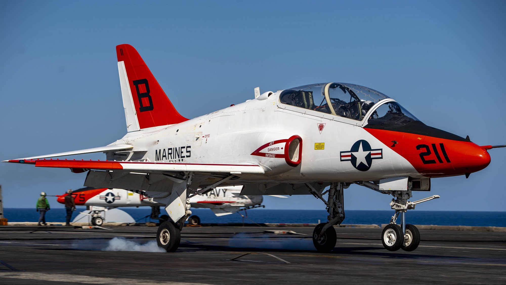

As an AF IP we trained T-37 jet students after only 20-30 hours in a C-172. There were also some total jet classes with zero prior time. I agree though that a progressively more complex series of aircraft would be more suitable
Vern
Vern
I was a T-41 instructor/ check airman at Laredo in the mid 60s, we were able to get a lot of students a good start for the 37. We didn’t washout many including Iranians.
Epilogue: My daughter commissions in May and goes to Undergraduate Pilot Training at Laughlin in June. All USAF basic flight training is now done in civilian aircraft (DA20, Archers) to get their (PPL, IFR, Multi and Commercial ratings, before they ever get into a T6 (UPT 2.5 I think they call it). I don't know if I did it right or not... but it seemed to work out okay.
While I do agree that the new T-6 is a bit strong for an initial trainer, doing step up training in the civilian world coming subsequently to military has little to do with logical progression and much to do with flawed acquisitions. Navy side, folks went from zero to T-34 to T-2 to A-4 with no problem; then folks went from T-34 to T-45… and they’ve managed from zero to T-6 to T-45 though such has had struggle, yet in Air Force land they have had struggles not in training but in maintaining as they have decrepit T-38s and overly used “new” T-6s that have finicky gear and lots of maintenance per flight hour; Navy isn’t far behind, T-45 has reached its life and they’re making stupid decisions regarding follow-on trainers due to a pressure from haste. Navy is currently running a “direct entry” helicopter program in similar fashion with individuals going straight to civilian helicopter schools to license while never touching a fixed wing primary trainer. As for T-45 replacement, they first scaled down requirements to not need to trap, merely do touch-and-goes to the boat, and have now further scaled down to not even need to land ‘Navy style’ thus only going to down FCLP entries to waveoffs not even full bounces… and they’re mandating PLM or “Magic Carpet” for all boat landings… so much for lessons of Children of the Magenta.
