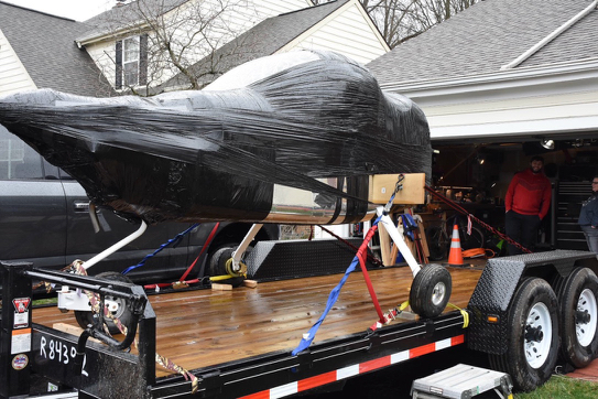

Waited until I was at the hangar
Here is how I did my move. I waited to attach the tail until I was at the hangar. I also wrapped it in plastic wrap. The cowling was off.
