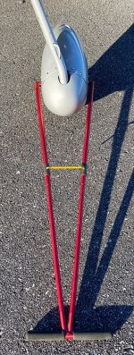

Questions:
1. Has anyone had the RV-12 tow-bar sold by Van's break at the T-junction where the legs attach to the handle? Van's told me they feel that our break is our fault for spreading the legs too far apart, but my partner denies that. Van's suggested I get a welder to repair it.​
2. Bogert Aviation does not sell a stock tow-bar for an RV-12 WITH wheel pant on the nose gear. However, they sent me their custom-build form to fill out and I am thinking of doing that. Has anyone had them build a custom tow-bar for an RV-12 with wheel pant? If so, can you share the successful dimensions you used in filling out the form?​
I have NOT been using the Van's bar to pull or push the aircraft in and out of the hangar; only for steering. However, in spite of my advice, my partners have, and it appears the axle inserts have popped out several times, damaging the nose wheel fairing.
We'll get someone to weld our Van's bar but save it for taking along on trips in the RV. For getting the aircraft in and out of the hangar, we need something considerably more substantial and with a more reliable wheel attachment method than the silly velcro strap affords.
I think this is the tow bar I purchased from Aircraft Spruce for ground ops at the hanger.
You will need to re-arc the legs so the don't rub on the wheel fairing...

I never had problems with the Van?s tow bar popping out. One minor modification I made that made it work better was to NOT stick the Velcro strap on the tow bar, but just make a loop out of the strap that can slide up and down on the upper part of the tow bar?the further you slide it down, the tighter the grip. Our tow bar has served well for six years.​
I use my tow bar exclusively for all towing. It broke at the "T" after about 4 years of use. I had it welded about 4 or so years ago and it worked fine. But, just recently one of the legs broke about 1/4" or more from the weld repair site. I suppose it was in the heat affected zone. I'm going to visit with another welder and see what he has to say about it.
